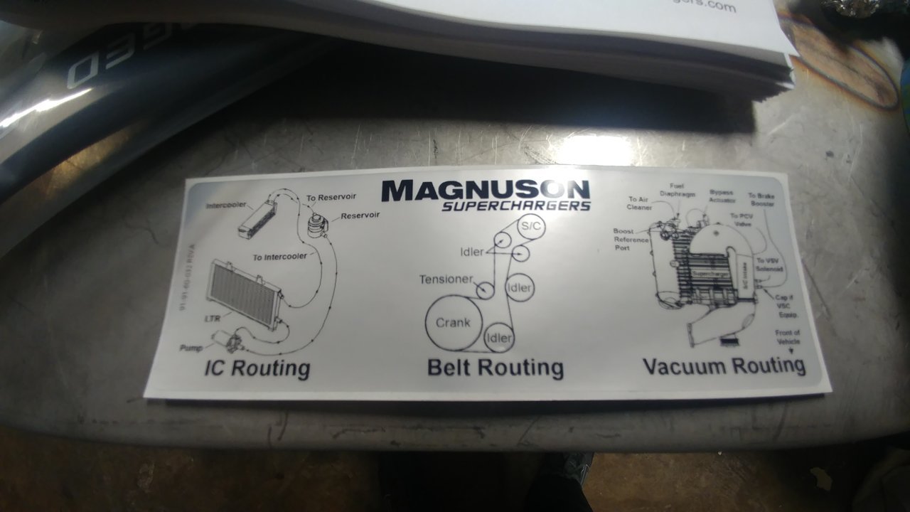

    Somebody wanted a pic if this sticker.

    I'm glad they wised up and put it all on one sticker compared to the TRD version stickers. They dropped the ball yet again though because they should had just put the CARB EO information on it so it's all on one decal.

    That was me. Thanks!

    very true but depending where you mount it I like having the separate stickers
