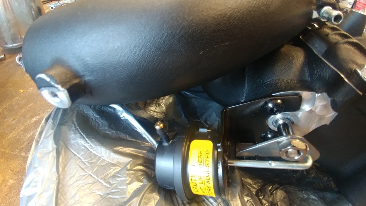

    Nope. If I just open the bleed screw nothing happens...

    Hah. I made a spare too. No problem. I don't mind tightening by snug and oomphs. I just thought the AL was too soft for what instructions called 21ft-lbs. I'll keep an eye on it.
    The stanchion is hard to cut. I'm pretty sure it's hardened so if you don't have good bits on the lathe, I'd let a shop do it. I have a 2.7 but labeled it similar to the stock pulley a 3.0 with engraving.
    nudavinci64[QUOTED] likes this.

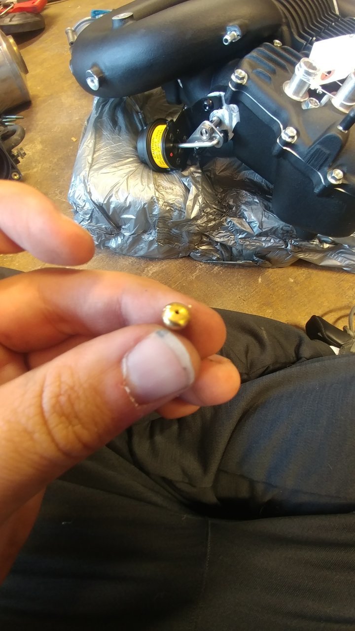

    Looks like they press in the jet for the bypass

    Can I get that little guy from you? Lol!

    If you don't like the delay of engagement that little jet has but still want to keep it in you can always take a slightly larger than hole drill bit and widen the hole a little bit. It will decrease the delay time and it will still offer the benefits of increase in delay of boost that you would otherwise have.

    I took that thing out and threw it in the bed of the truck. Need to get over this lazy spell and get truck together. Depression is a bitch.
