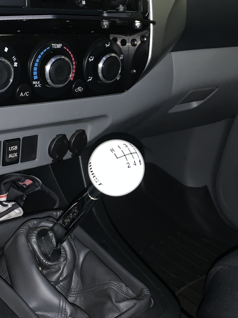

    This? https://core-shifters.com/products/...r-2005-2015-toyota-tacoma-v6-6-speed-ra60-4wd

    Yeah mine was the shifter mechanism complete that snaps onto the trans. It was a little of a pain to line up the pivot ball to where it snaps in while trying not to smear the gasket. Once it’s in, you just need to bolt the arm on with the 2 supplied bolts and screw on the knob. In that pic, there are 4 bolts on top of the shifter mechanism that may indicate more to assemble.

    I only have the stock and the TRD quick shifter to compare to. It’s nice and tight. Easier to get into reverse (not that it’s hard) but it is easier. Crisp quick shifts......love it. The only thing I’m trying to get used is the grey TRD shifter ball was nice and big. Like the size of a billard (pool) ball. The hurst ball is small, like the size of a lime. It’s not that I don’t like it, it’s just different and I need to get used to it.

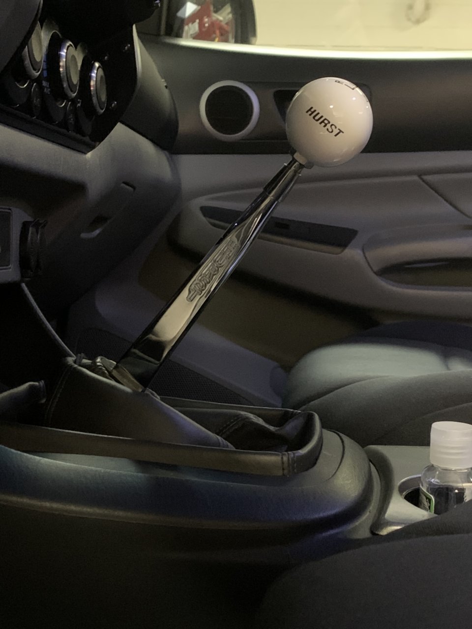

    Only reason I went with URDs short shift over Hurst was the ability to keep the shift arm boot in a more stock position. The Hurst isnt round, so it keeps the boot really smashed down at the bottom.

    The boot part doesn’t bother me. I actually like it down like that. The hurst is a little longer too which I like.
