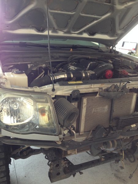

    Hey, any of you boys with a URD tcai have problems with the install due to the s/c intercooler? With the intercooler being in front of the radiator I figure it would probably bump the cone filter out towards the grill more......

    Mike rubbed the intercooler so I moved it to here prior to engine cage and moving it again.

    Mine was going to rub with the URD bracketing and so i made a bracket out of aluminum flat bar to push it forward more. It is in the stock URD TCAI location now without issue. I can get a pic later of my hacked together bracket if you're interested. Very basic design, i think i even kept the URD mounting points, just made an extension

    Yeah please if you don’t mind. Did you have to make extensions for the Maf or did it come with a premade extension?

    Flip the bracket, widen the hole ever so slightly so the bolt goes through the smaller hole and it'll push you out enough to not cause issues. I ran mine like that for a very long time prior to changing it then ultimately selling it.

    It comes with a pre-made extension yes. I did have to cut some plastic out of the inside of the grille to make it work - I also have the metal shield for the filter installed.
    I'm interested in what you come up with @BassAckwards because mine has been rubbing on the intercooler since I installed it. Lucky so far I haven't gotten a leak.

    Also, you won't get a leak. The intercooler fins do not contain coolant and are quite thick. The brass tubes within do, so you can rub off fins all day long, but if you rub through the tubes THEN you will be in trouble.
