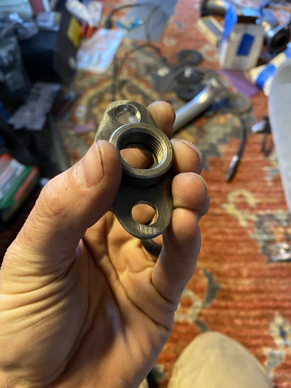

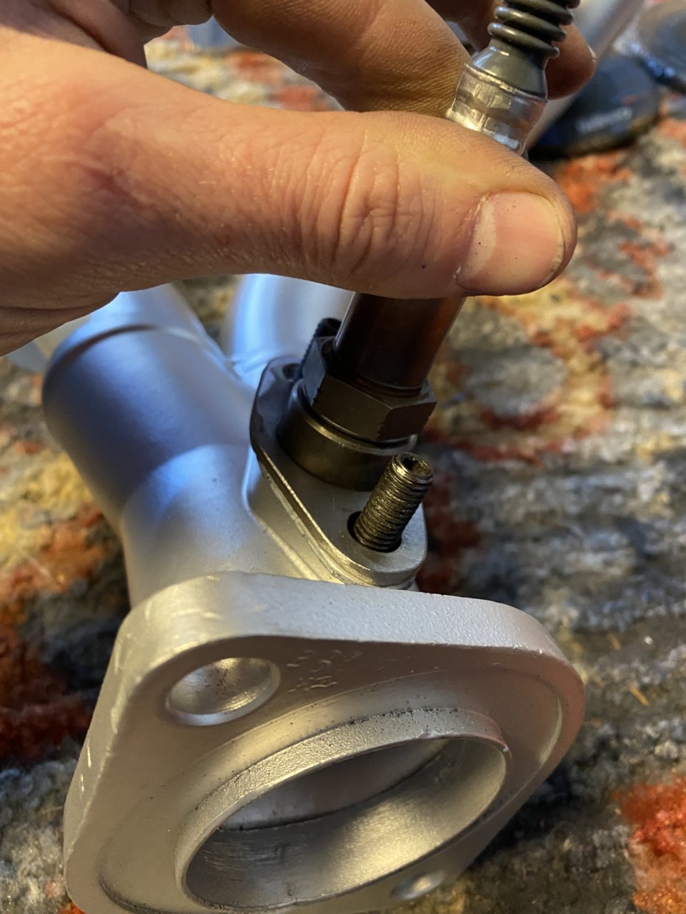

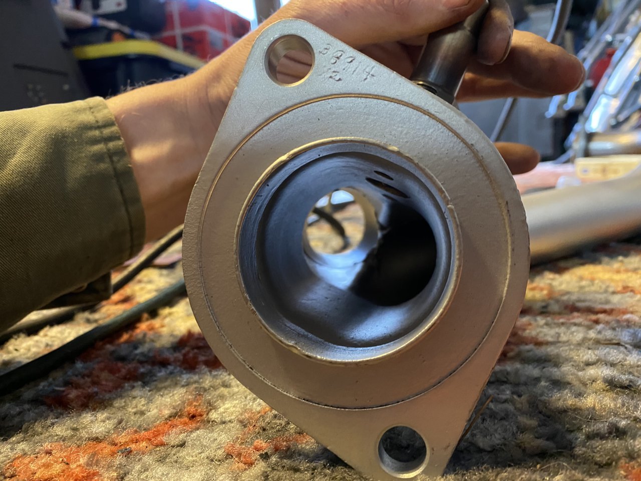

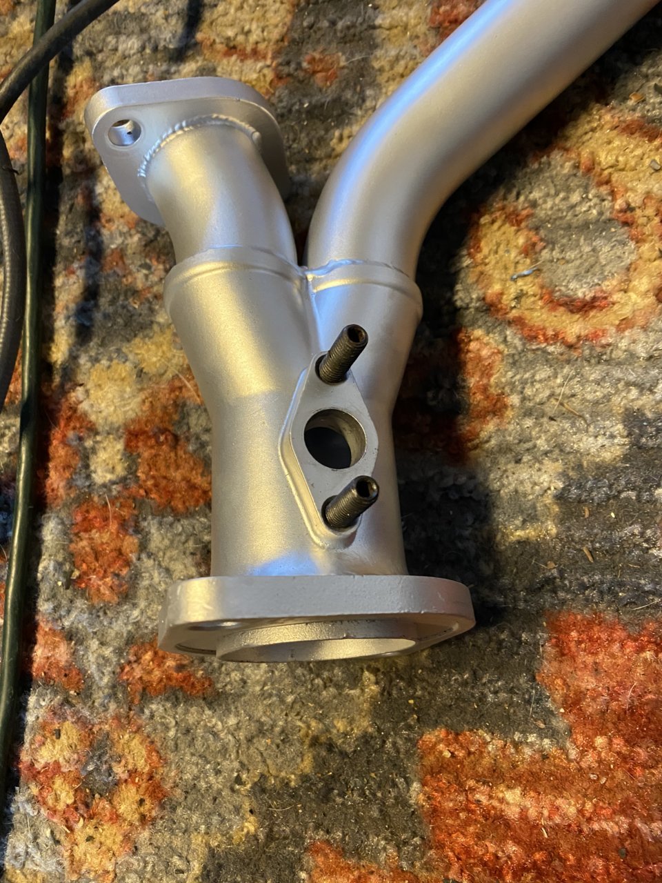

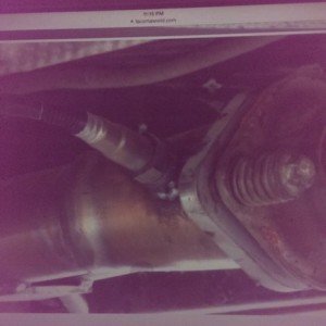

    Hey everyone. I was redirected to this thread in hopes someone here can help.
    I bought an Innovative gauge and they sent me a bung to weld onto the exhaust to install the sensor. Duh. Well, I just had my headers ceramic coated and there’s no way I’m going to be welding anything directly to them.
    So I’m making my own “bung” and was wondering if there’s an optimal depth radially that the sensor needs to be sticking into the exhaust.
    I assume that being tucked up a bit will help keep direct fire off of it, but too far in could skew readings? Perhaps I’m putting too much thought into this.
    Photos for reference.

    Something like 11 or 2 o’clock position.

    Is there enough thread engagement to sand off a little more of the bung?

    I could take another two threads off comfortably. I’ll do so and run with it.

    Oh, another thing. Do not remove any threads off at all. As long as the sensor is in the exhaust system and actively working you won't have any reading issues.

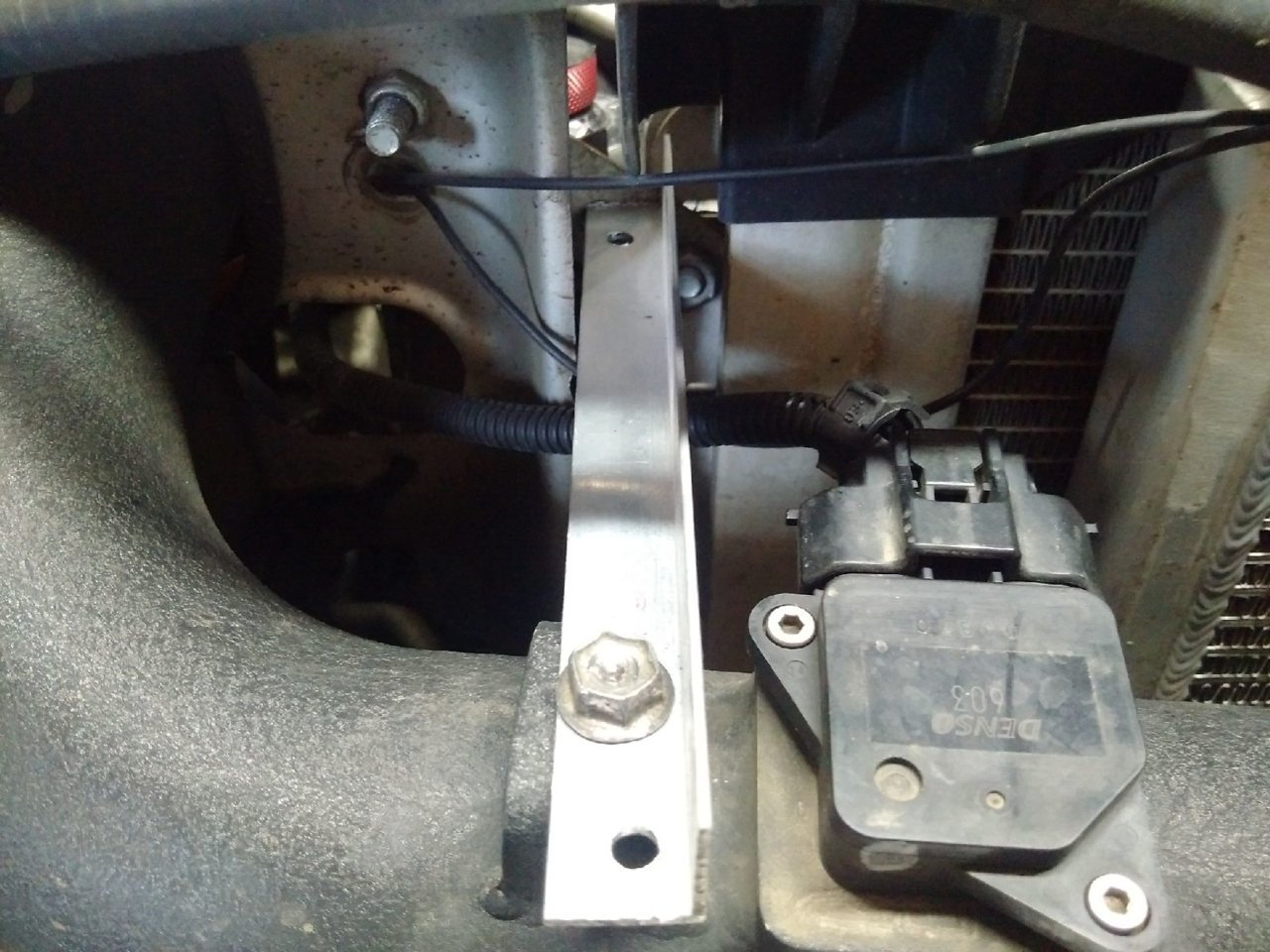

    Threw this in at lunch. Little piece of scrap aluminum I had sitting around. It pushes on my janky radiator support bracket so it's rather good. There's even a hole in it, in case I ever want to install something else (as an engineer, I usually will find a reason to fill an empty hole).

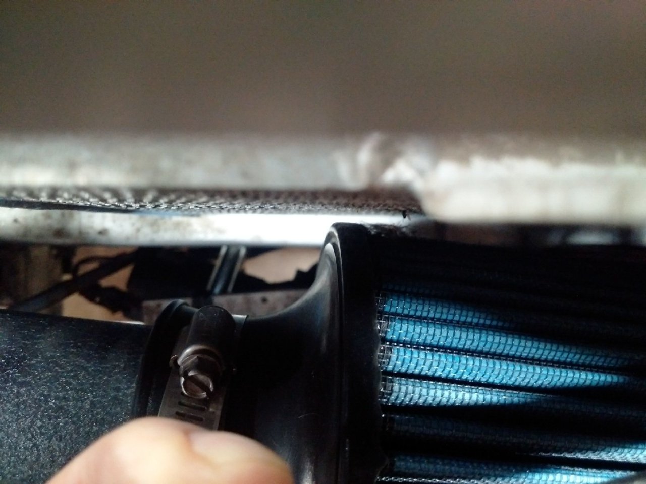

    Sure thing, no problem, ill post a pic later.
    Also, i wanted to note that the shield that URD sells is not so much for the rain or snow, but rather to keep the MAF from being disturbed by turbulence at highway speeds. Its an issue with 6 speeds only from what i understand. If you have the URD intake installed and you're driving say 65mph or above on the hwy and you push in the clutch and dont immediately shift/release the clutch, the truck will die due to turbulence across the MAF.
    I have noticed that it helps with the rain too but you have to make sure the top of it is angled back slightly so the water can run off of the shield and not drip right onto the filter itself. I can post a pic of how mine is set up. I was having issues with the rain causing the filter to get wet during rains and had to clock it slightly to correct it. It was causing sputtering under WOT, which i assumed was water going across the MAF
