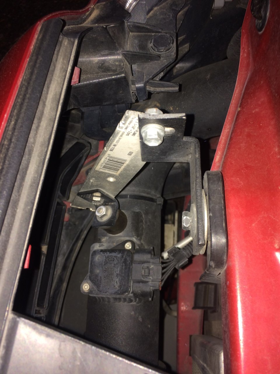

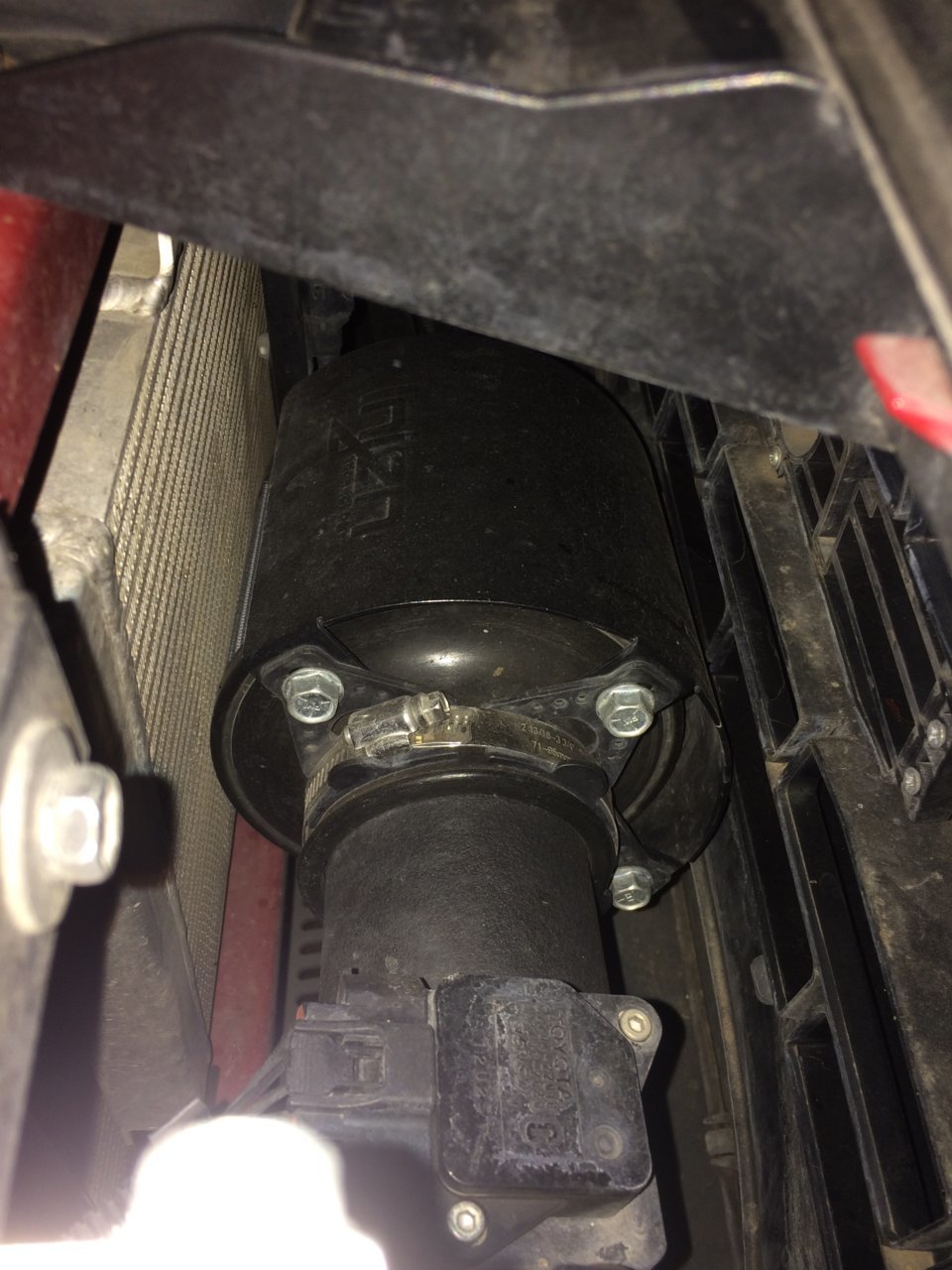

    Here’s a pic of how I have the intake shield clocked. You can see the top part is turned further back towards the heat exchanger. When I first had it mounted I had that part straight up and down with the edge in the center. First time it rained the filter got soaked. If you clock it back, it should help the water run off and not onto the filter. I am running a Cali-raised fake TRD pro grille insert, and I didn’t have to cut anything for fitment for reference. My truck is a 2013
    And here’s the hacked up bracket I made. I used a piece of scrap aluminum I had laying around which is why it’s not purty, but it works good. It’s literally just piece of flat bar with some holes drilled in it. As you can see the stock upper and lower brackets are both URD. I only changed the middle piece out to push it forward more. There is about a 1/4” of clearance between the filter and the heat exchanger.
    Oh also during install, you will want to tighten up the piece of piping on the throttle body first, and then the front section near the grille second. This will allow you to hold the filter with one hand, ensuring it won’t rub on the heat exchanger, and then you can tighten up the last clamp in the middle (the one near the washer reservoir). In other words, the way you tighten up the clamps and where the piping is when you do so can also have an effect on clearance. Hope this helps some man, if you have any questions, feel free to shoot em my way
