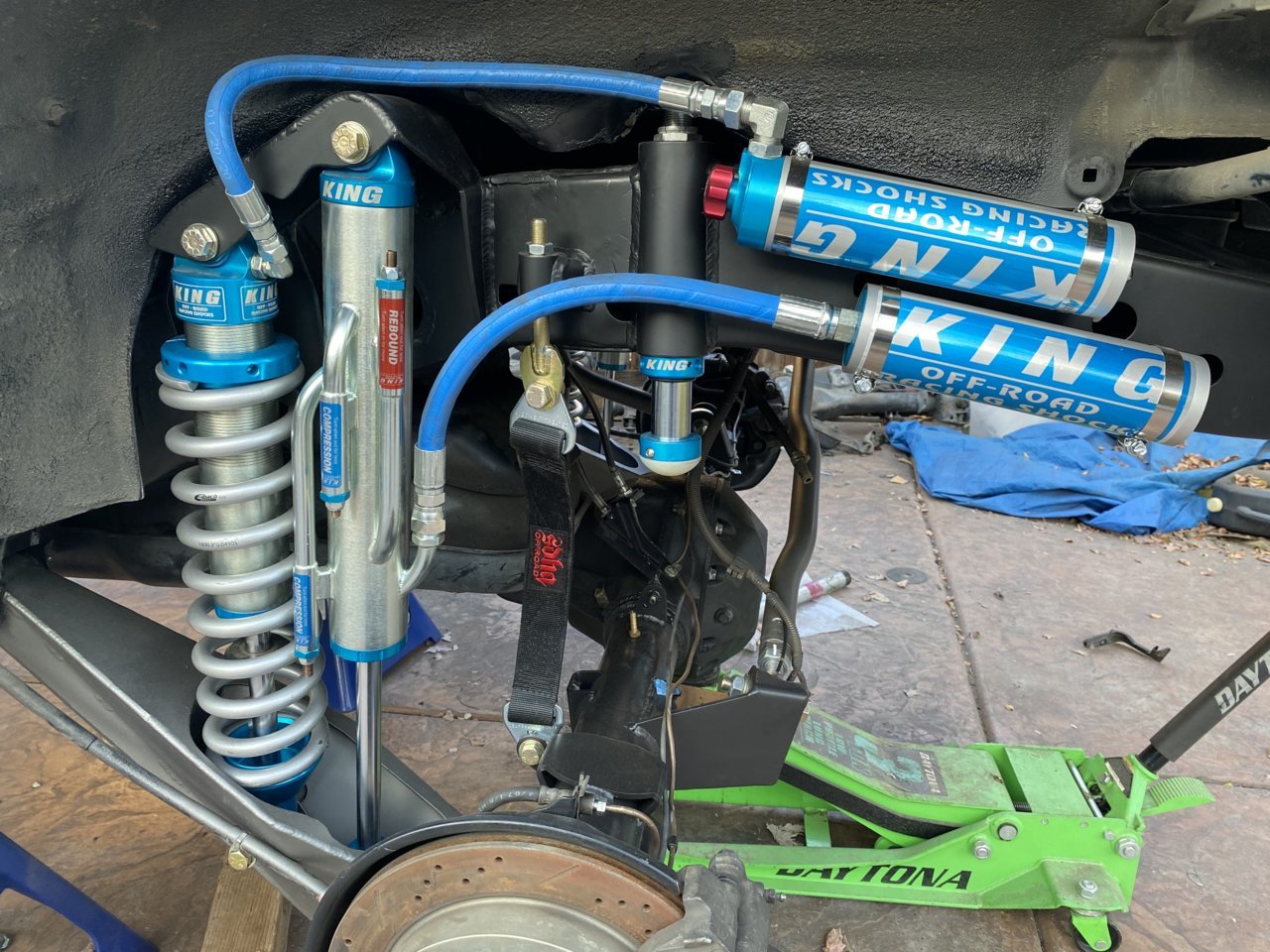

    That's one crazy rear setup, love it! What was the difference in the WAT vs Ratiotek? I remember you noted you were going in another direction but had no idea exactly what you were doing.

    Umm, I mean, that's not incorrect.

    Yeah I’m gonna need some videos of all this in action and you to tell me how terrible it is so I don’t do this to my wife’s 4Runner

    Yeah will do. The rear's ready to sit on its own weight. The front had a small setback with the collection of modifications. The subframe kit intended for the Tacomas has about 1" wider LCA pivots than the FJ. So with the cams all the way in, I'm still getting 2.3-3 degrees neg camber. I knew about this prior to executing, but I thought there was a chance it would adjust in ok. I'm currently converting my Dirt Designs UCA's from bushings to Hiems so I can correct my camber. Should be good to go shortly. Hopefully my axles have enough stretch. I think they'll work.
