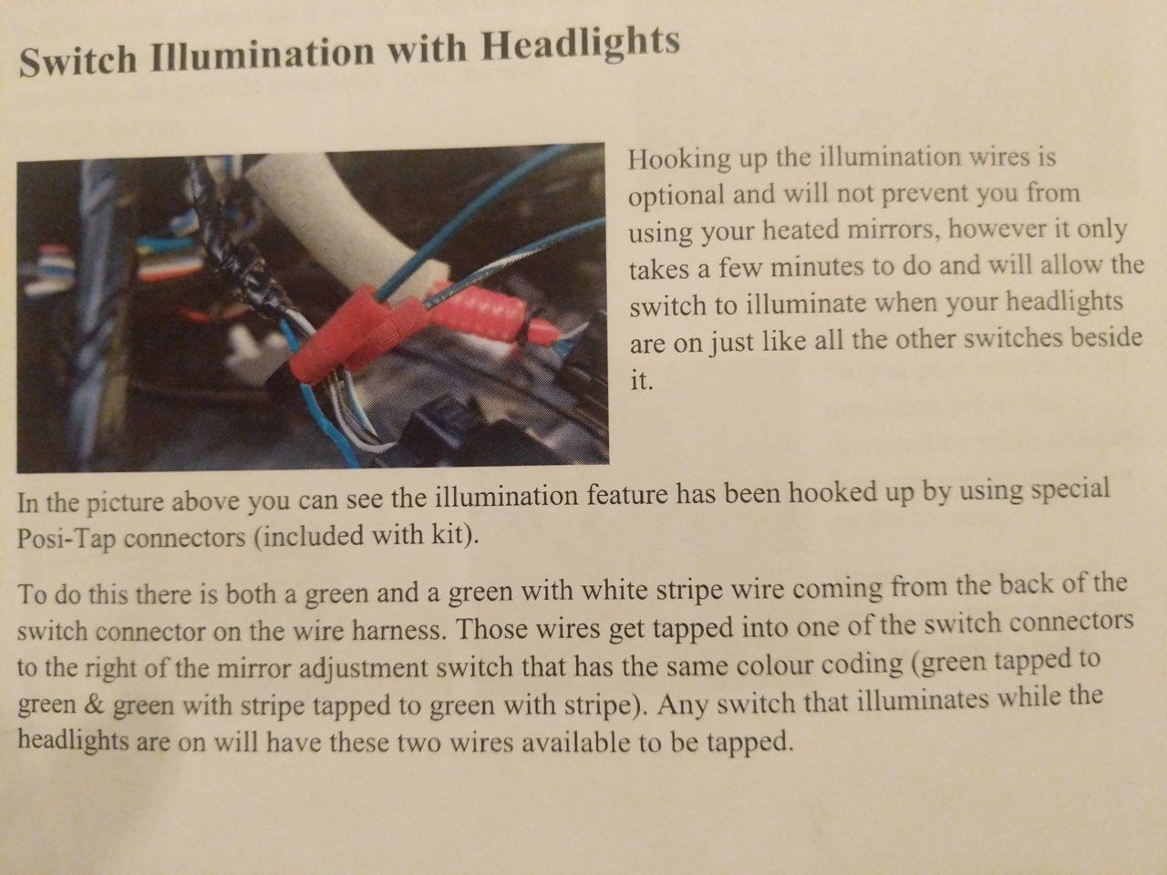

    Anyone got a good wiring diagram for the headlight interior dimmer? Was gonna install my boost gauge and wanted to see if anyone had one handy.

    No wiring diagram but from info from my heated mirror kit instructions. The button illuminates and was tied into two wires (green = 12v hot with headlights on, green/white is variable ground) from another lighted switch.

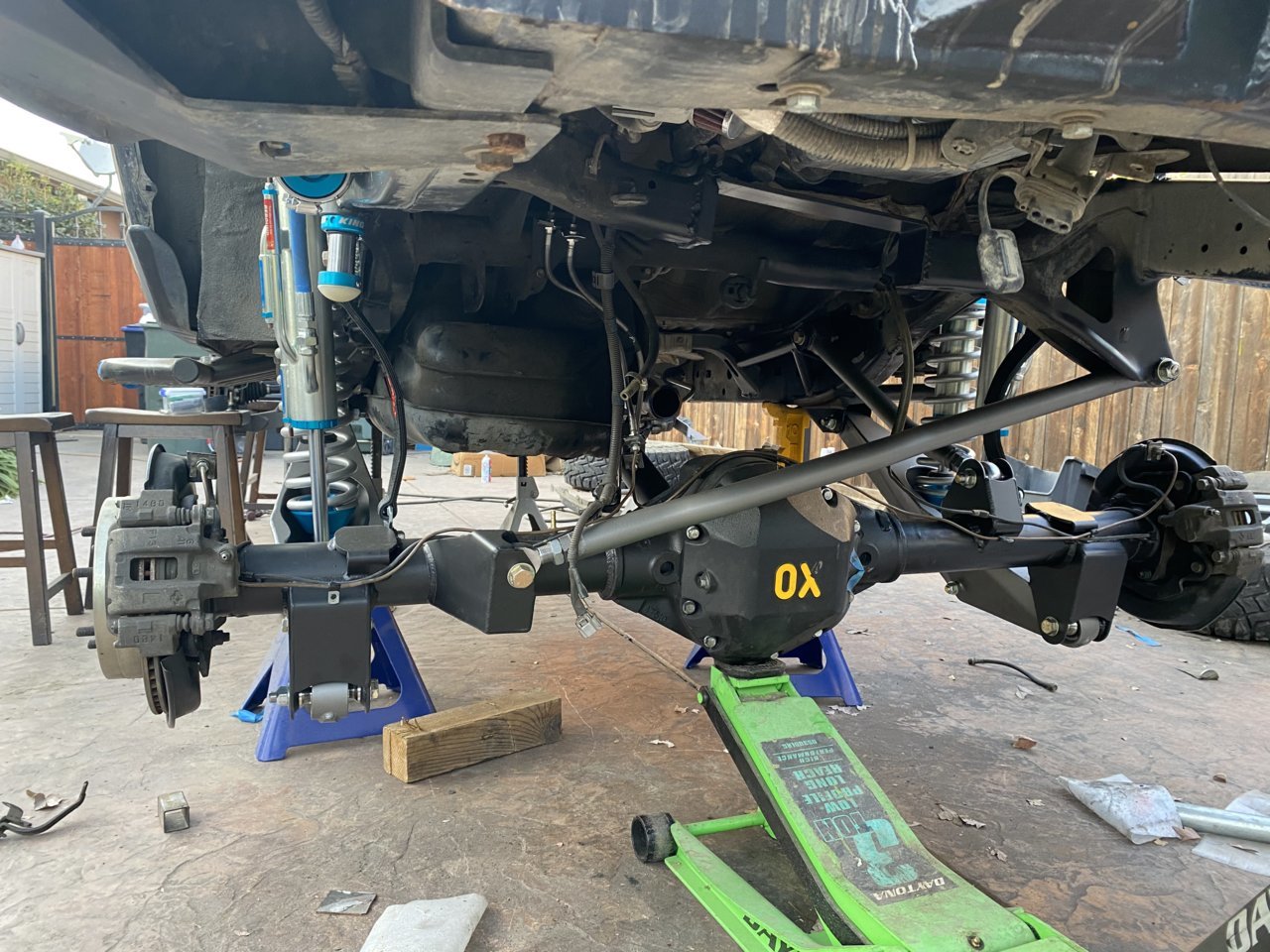

    Your better off with the 60. Talk to Chase about the 9". I talked to him about having him build me a 9" for a F9 axle housing and he proceeded to give me the reasons why a 60 is far superior to the 9". Yes, the 9" looks cooler, but it is in no way stronger or better for a truck that is in the rocks.

    The 60 housing and tubes are harder to truss than the 9”. Having a cab over the rear end, I don’t want to give up to much up travel. I’ll figure something out.
