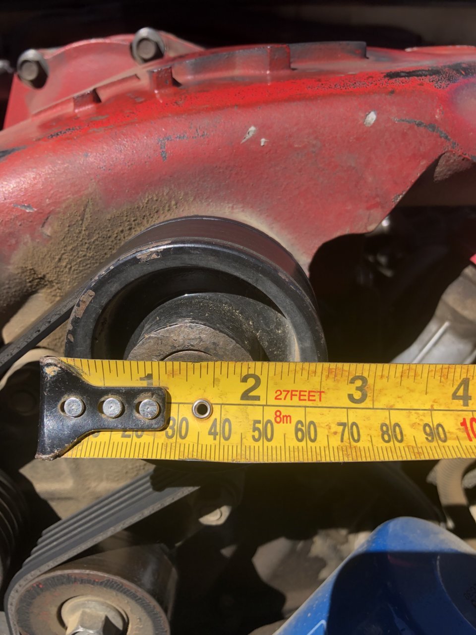

    Fyi... 2.7” pulley I’m running

    Or a bit closer to 2.6 I’d say

    I actually think that's a 2.5. Don't they measure the diameter from the top of the ribs?

    Yes they do.
    That's definitely not a 2.5.
