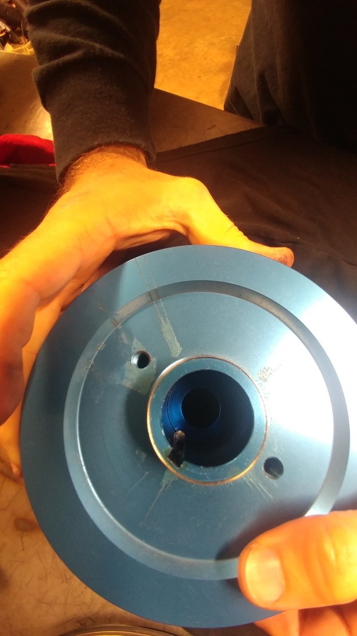

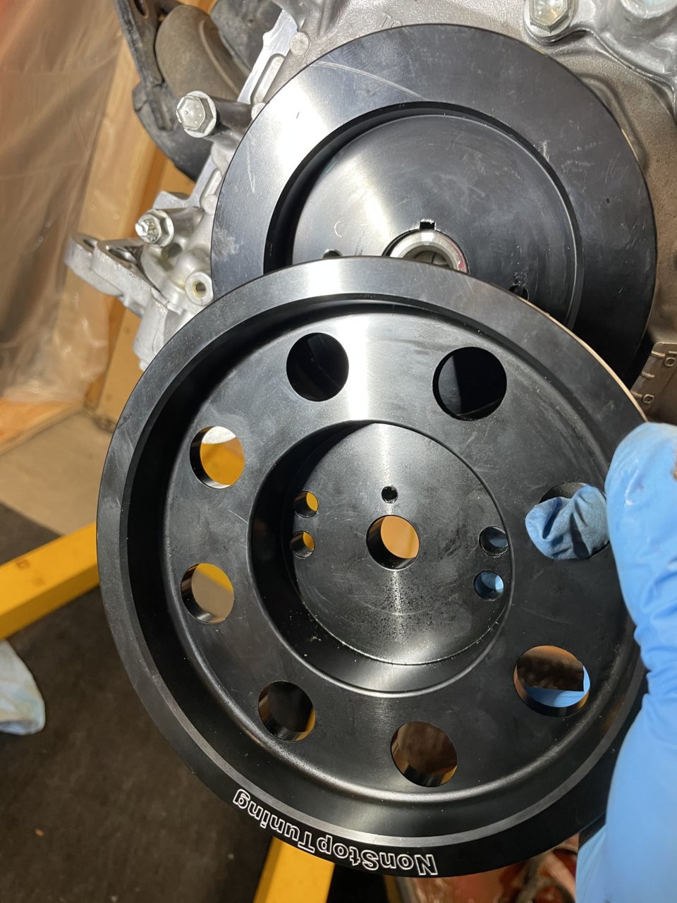

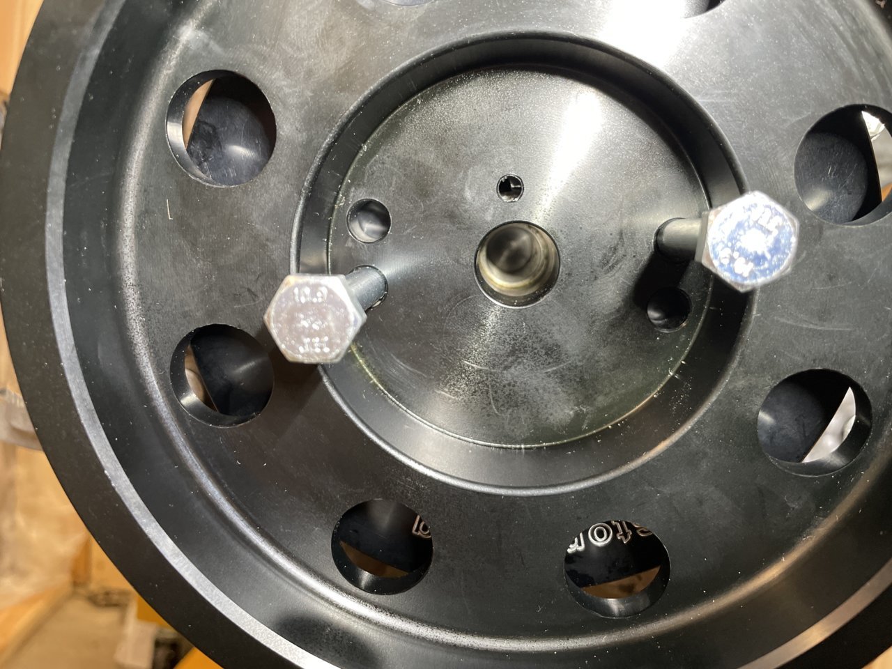

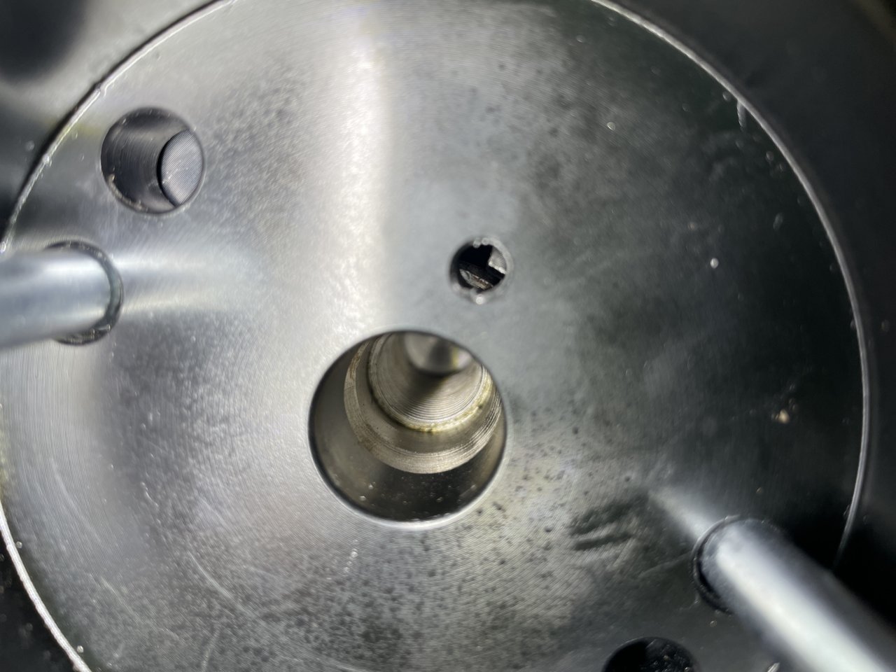

    How important is the dowel? NST SC crank pulley matches the stock one. The NST crank pulley has holes that don’t match stock crank pulley.

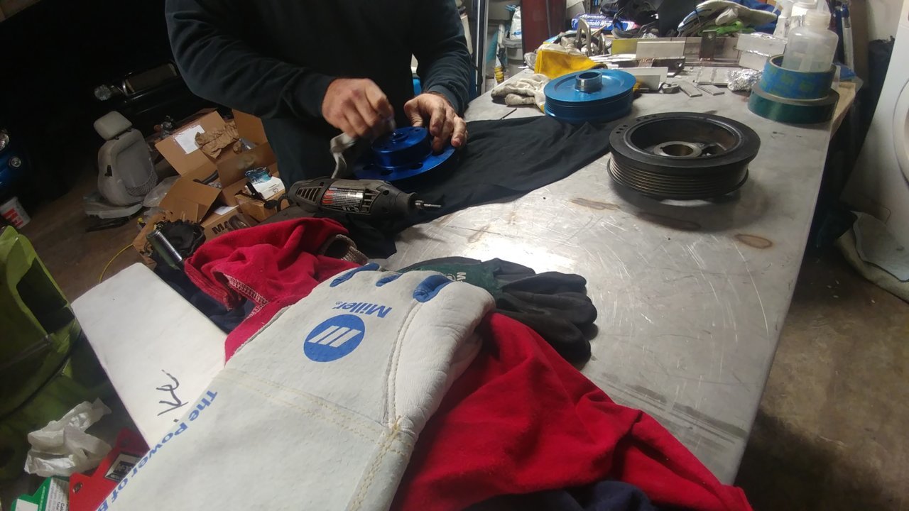

    I had mine swapped. @Torspd and i also widened that key a bit too for better engagement.
