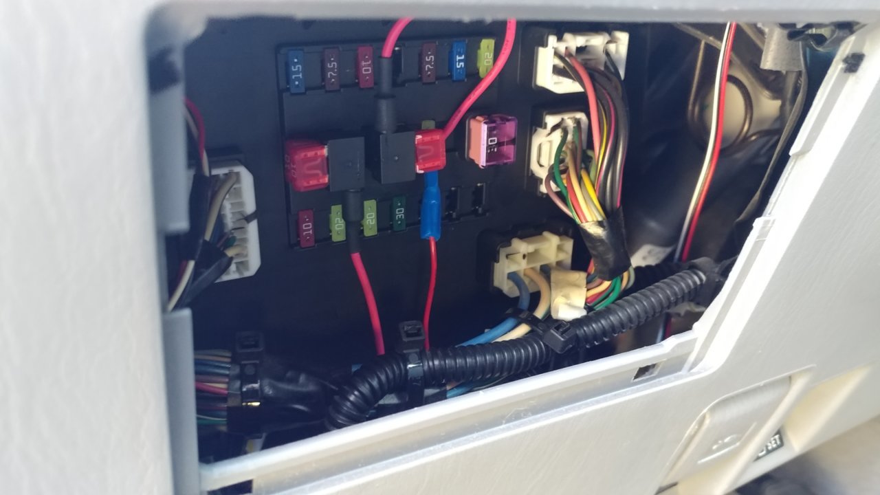

    I have been meaning to buy something like this. Did you use the ign on fuse in the engine bay or did you snag one from the interior for that box? I think the washer fluid fuse in the cabin is on w/ ignition only. I know the only issue with the one in the engine bay is when the truck is doing that pesky evap test it comes on.

    That's only on when the stalk is activated on com and with key on.

    Weird. Maybe I’m using the horn one then. I can’t remember but thats what I have powering my boost gauge lol

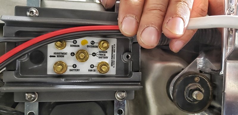

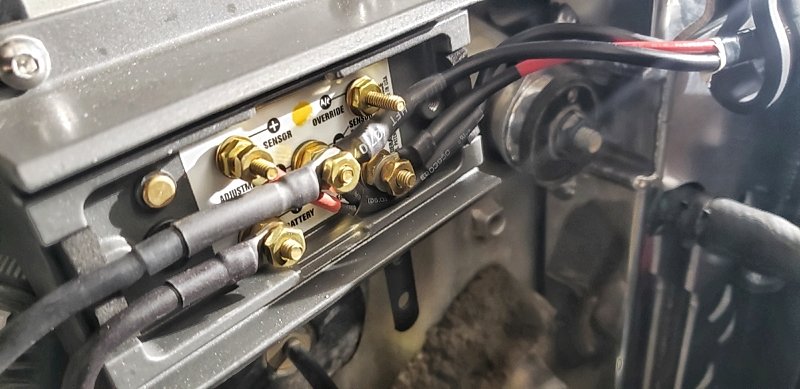

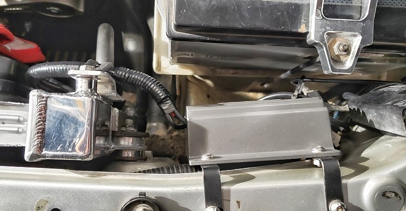

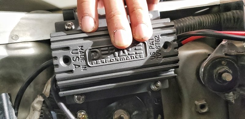

    Some wiring inspiration. Took me a while to figure out how I wanted it . I heatshrank the insulated wiring and doubled up on the ends. Also crimped and soldered the terminal ends. I have a not so fancy flex a lite and derale pwm fan controller. It barely turned on with the 170 degree thermo so I'll have to spend time adjusting it.

    Yeah. I had bought the FAL fan awhile ago before researching much crazier options.The Flex-a-lite comes with a fin insert thermo sensor but Derale has a "better" stick on aluminum sensor that attaches to the radiator closest to the lower hose. Fan + temp sensor run into the fan controller on one side, while 12v and ground run opposite along with the stock harness. I omitted the alternate switch but it has a hookup for such.
    You can see it here
    Murphinator likes this.
