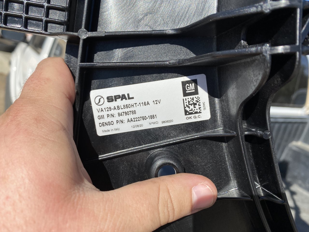

    I got my fan this morning but haven't opened the box yet. UPS showed up surprisingly early to deliver it though and the box looks intact so it looks like everything should go okay.

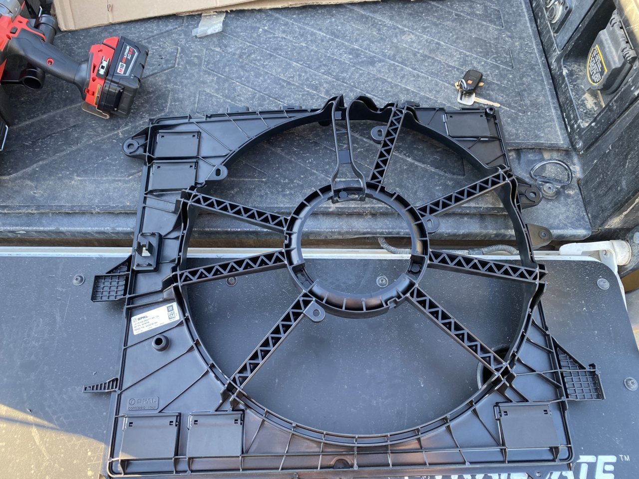

    It's the same deal on mine as well. The arms hit. 3D printed parts are easily moldable so if you apply some heat to them you could probably bend the arms out a little bit while you heat the mounting tangs.

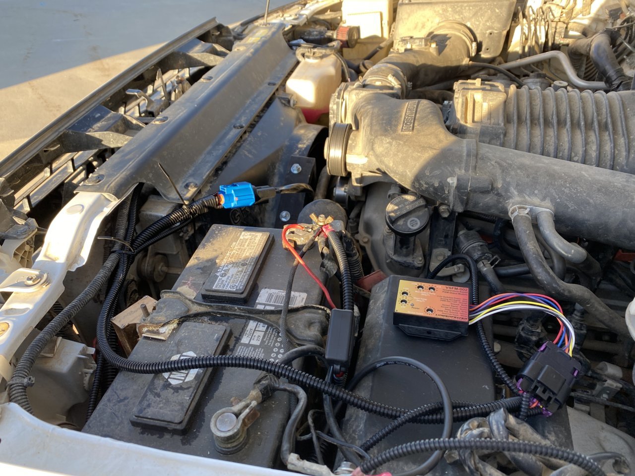

    There appear to be an excess of wires outputted from the premade harness. I would assume some of those are in place to rig in an always on fan switch. I don't think I'm ever going to use that function as I do not see the need for it so I may just end up picking out the wires and stowing them away instead of having an excess bunch of useless wiring hanging around.
    I'll probably install the fan sometime this week or next week. We'll see how it goes.
    How are you liking yours so far @Murphinator ? Any improvements overall? I really just got this so I can reclaim my otherwise nonfunctional AC in the summer because after multiple summers I am absolutely SICK of being barely cooled off in 90+ degree heat at idle.

    I got mine all bent out now. I used a hairdryer and held the heat on the mounting tangs until it got uncomfortably hot while I applied pressure with my finger on the side that doesn't have a bolt on it and took my other hand to bend the rest of the mounts upward. No more rub.

    Rather than modify the arms I think I am just going to make a custom shroud for it. I will say when you install it if you follow the directions on mounting it in the shroud the arm is going to make taking the upper sc tensioner bolt near impossible atleast from the top of the truck. You may be able to position it so that does not happen but I didn’t even think of it until I put it in the truck.
    I like it so far. Granted it has been cold and rainy so I can’t really push it hard. I am in the same boat as you, I got it for summertime ac performance and at idle this fan will move a lot more air than the clutch fan ever could so I think that issue will be solved.

    I thought you would also want that overrode always on button so you could use it as needed? Likely it will be on but one reason. Would be to flip on as needed.
    Thinking using the shroud it came with. if a frame was made that entire shroud could bolt right in. Already has the shroud flap deals on it as well.
