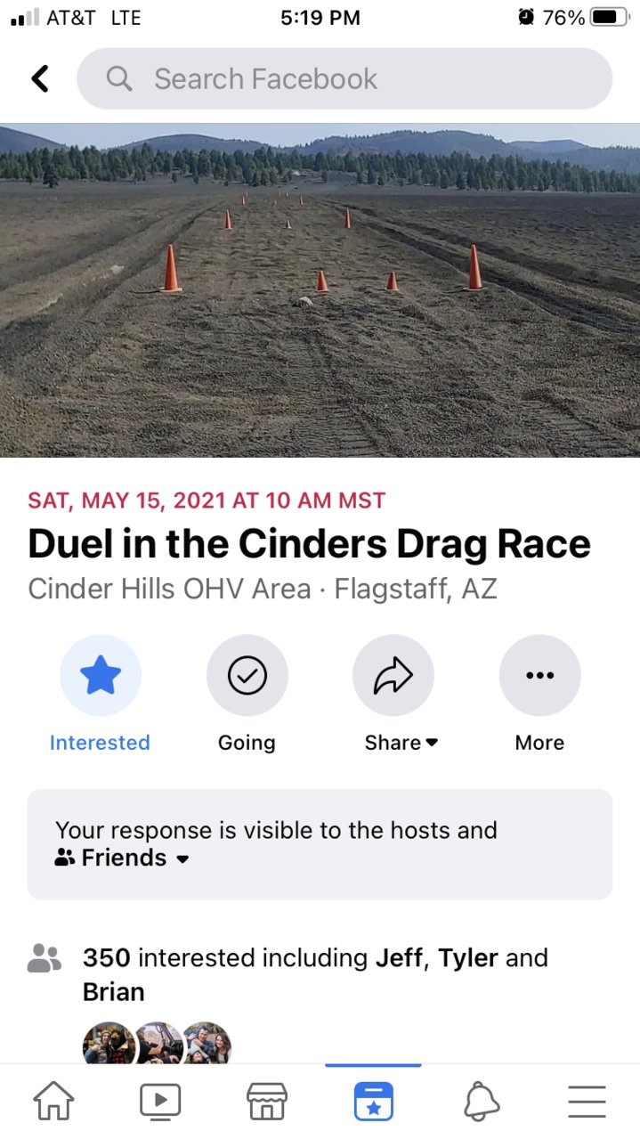

    Has anyone relocated the 12V tap for the supercharger pump so it isn't running randomly when the truck is parked? I'm diagnosing a potentially failing battery and the occasional drain while the truck is parked overnight in <30 degrees isn't helping. Also, when I am running a single battery with a Dometic fridge, I want the least amount of random drain unless it is necessary.
    I still need to get my DSCB onto a scale after I transferred the Vagabond Drifter onto it and put in a bed divider, fridge, bedrug, and some other semi-permanent things like my toolbag and extra fluids… But it sure is fun launching with TRAC OFF into turns and then having traction catch and fly away from crowd-eating Mustangs...
    I will be WAY overdue for some mountain biking and camping in AZ, so I put it on my calendar. At least to watch. I'm not sure if I'll participate. If I do, it will be hilarious with the camper on the back and my bike(s) hanging off the hitch on a rack.
    I just drove by a regular cab 2nd gen earlier this evening that had temp plate and it got me thinking that a really fun daily would be a 5-lug regular cab with a V6 and supercharger... Maybe a railroad tie mounted in the rear of the bed to help with traction like my grandpa used to install at the Ford factory when building the 60's Econoline vans...
    What do you use for logging? Cable and software is what I am lacking right now (and laptop, but that is easily solved).
    Remove rear seats, passenger seat, tailgate, carpet, plastic cubbies behind the rear seats, center console… That shouldn't take too long to drop a few hundred more pounds.
