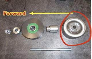

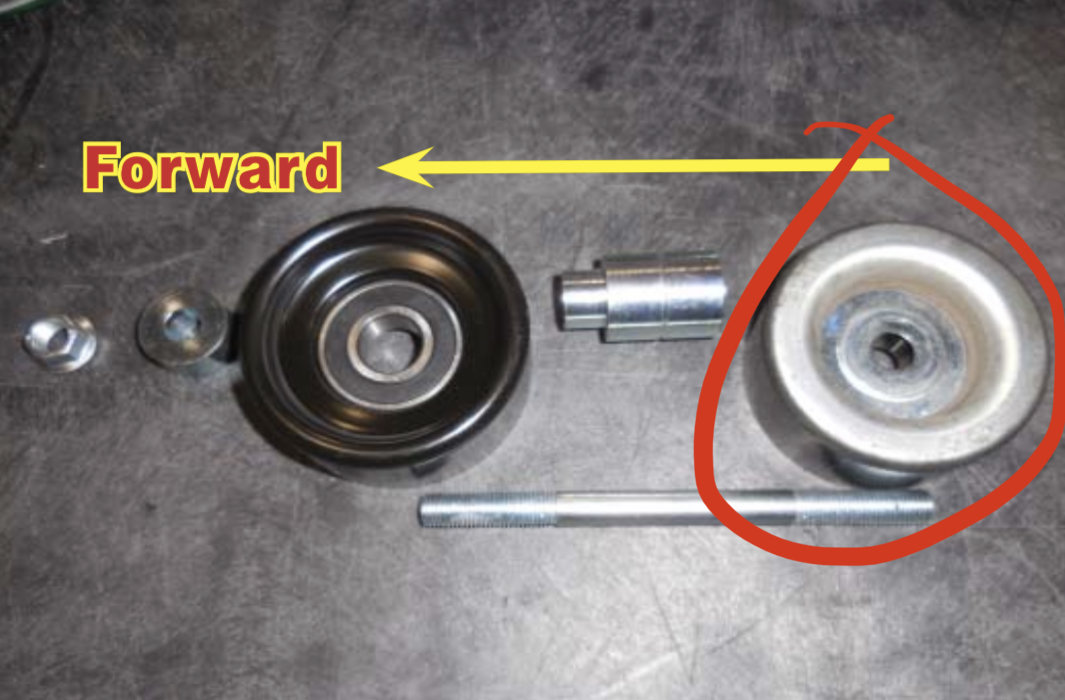

    The main serpentine pulleys are not the same size. Maybe you got them backward.
    otherwise there maybe a manufacturing problem with the spacer.

    Took everything off and triple checked against the stock serpentine idler (I replaced them while I was in there) and they were an exact match according to my micrometer. Part numbers were right too.
    I shaved a bit off the spacer and everything lines up perfect now. Took another long drive and everything stayed where it should. I'm guessing the spacer, crank pulley, and/or small ribbed pulley had some slight manufacturing differences. Who knows? :notsure:

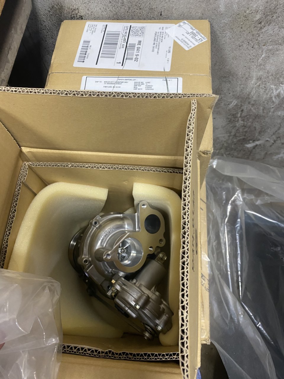

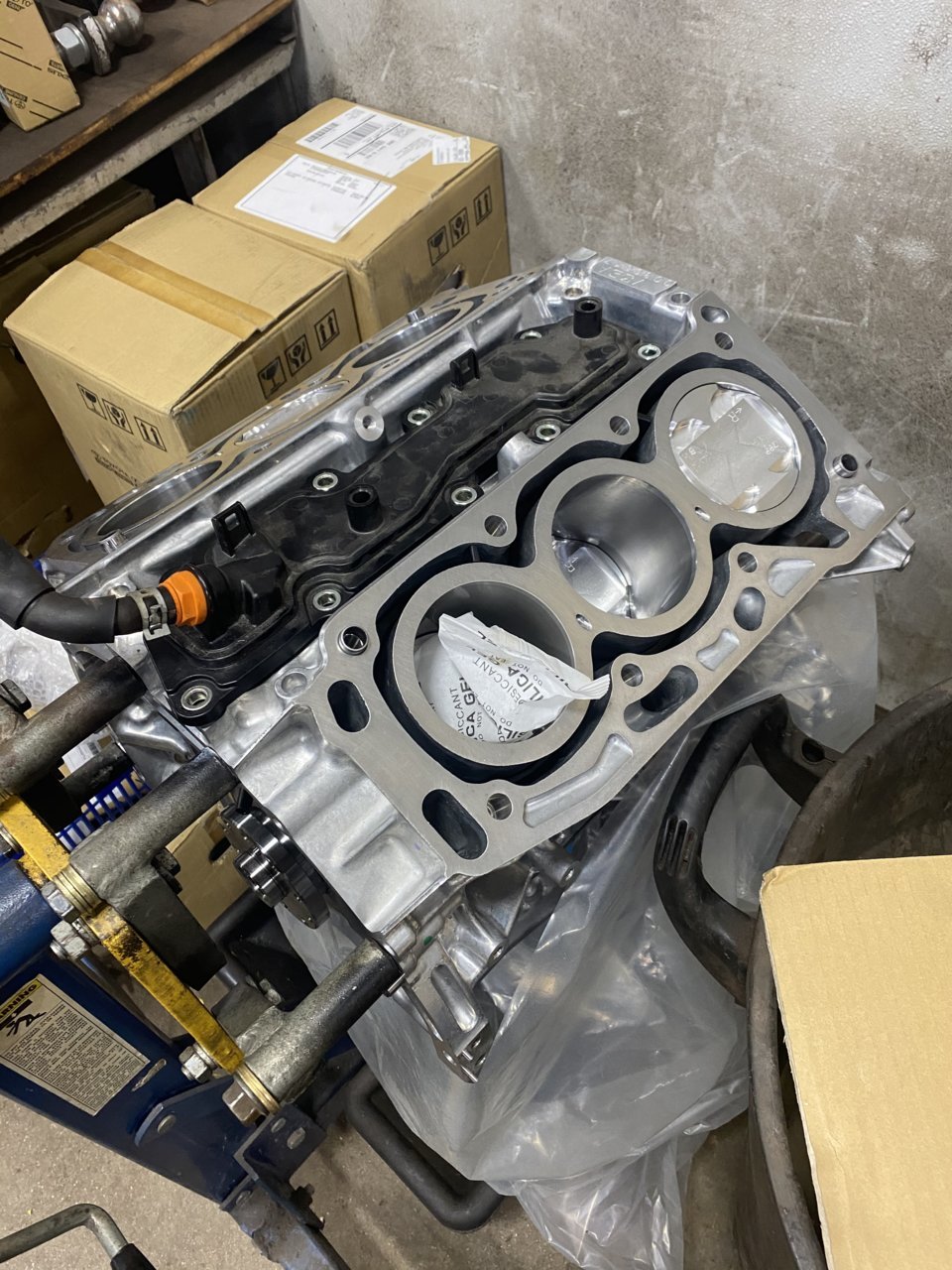

    Also working on a side project for Lexus. Rebuilding a 2019 ls 500 motor. 3.5 twin turbo. Billet pistons and turbine wheel. FD5D8408-F1D7-4B93-9FE8-DE02E5876C6F.jpgD8C79FD0-C041-47B8-9940-2AB01CBB0AAB.jpg

    Yup. Very small. Don’t no how it makes power. I’ll show some more pics showing the exhaust port side. And the turbo size. Very small

    Around 500hp I’m pretty sure. I got short block. With new heads. And new turbos. Bunch of small parts. For the low price of $38k in parts so far hahaha
