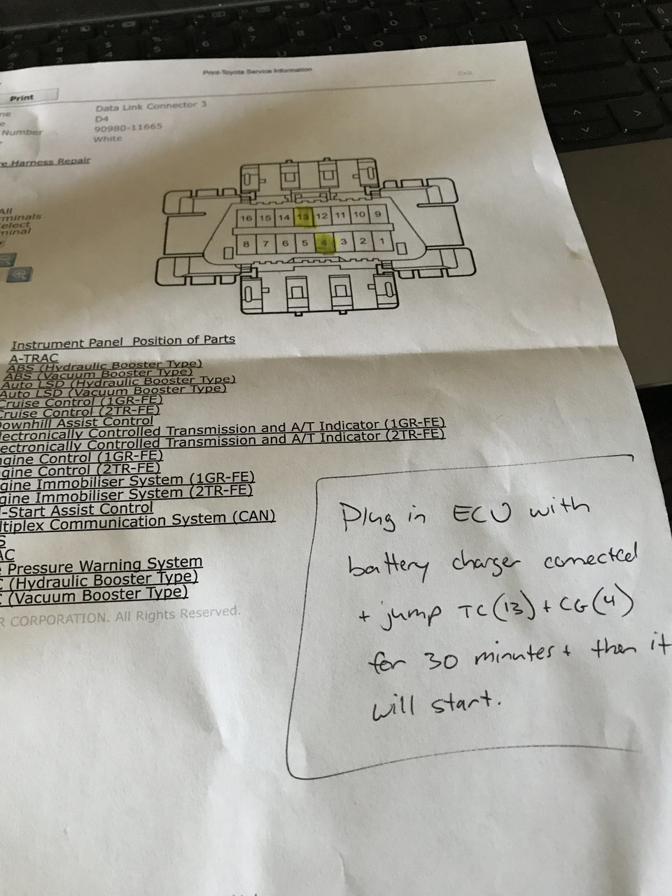

  14. Nov 12, 2017 at 9:01 AM
    #334
    jojotoo
    jojotoo Well-Known Member
    Feb 20, 2017
    #211129
    582
    Brandon
    Socal
    2015 DCLB
    Here’s a drawing ..
    Torspd, loginfailed[QUOTED] and GT7 like this.
  15. Nov 12, 2017 at 9:06 AM
    #335
    loginfailed
    loginfailed Well-Known Member
    Aug 29, 2016
    #195923
    5,156
    Dwayne
    Houston, TX
    2014 DCSB 4WD
    Perfect

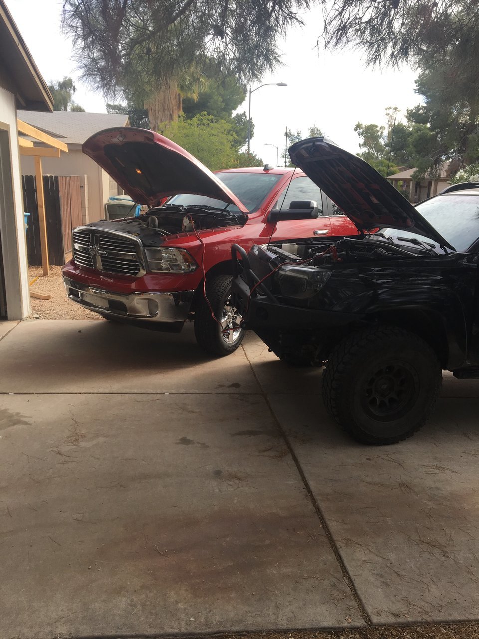

  20. Nov 12, 2017 at 9:56 AM
    #340
    GT7
    GT7 One piece at a time
    Aug 15, 2014
    #136201
    2,502
    Grant
    Phoenix
    2013 DCLB
    oni06, Torspd, jojotoo and 1 other person like this.
