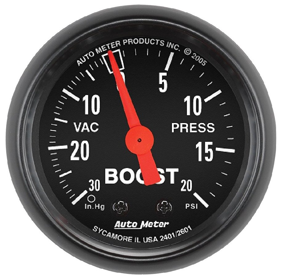

    5, 10, and 15 psi were large... 20 is def useless but atleast its small.
    I just couldnt find a big name gauge that stopped at 10 or 15 psi and i wanted the vac option as well as it being mechanical. I didnt want to play with sensors and add 1 more item into the loop to malfunction.
    Theres almost always a genuine 10psi trd boost gauge on ebay for around $300-$400 sadly :(

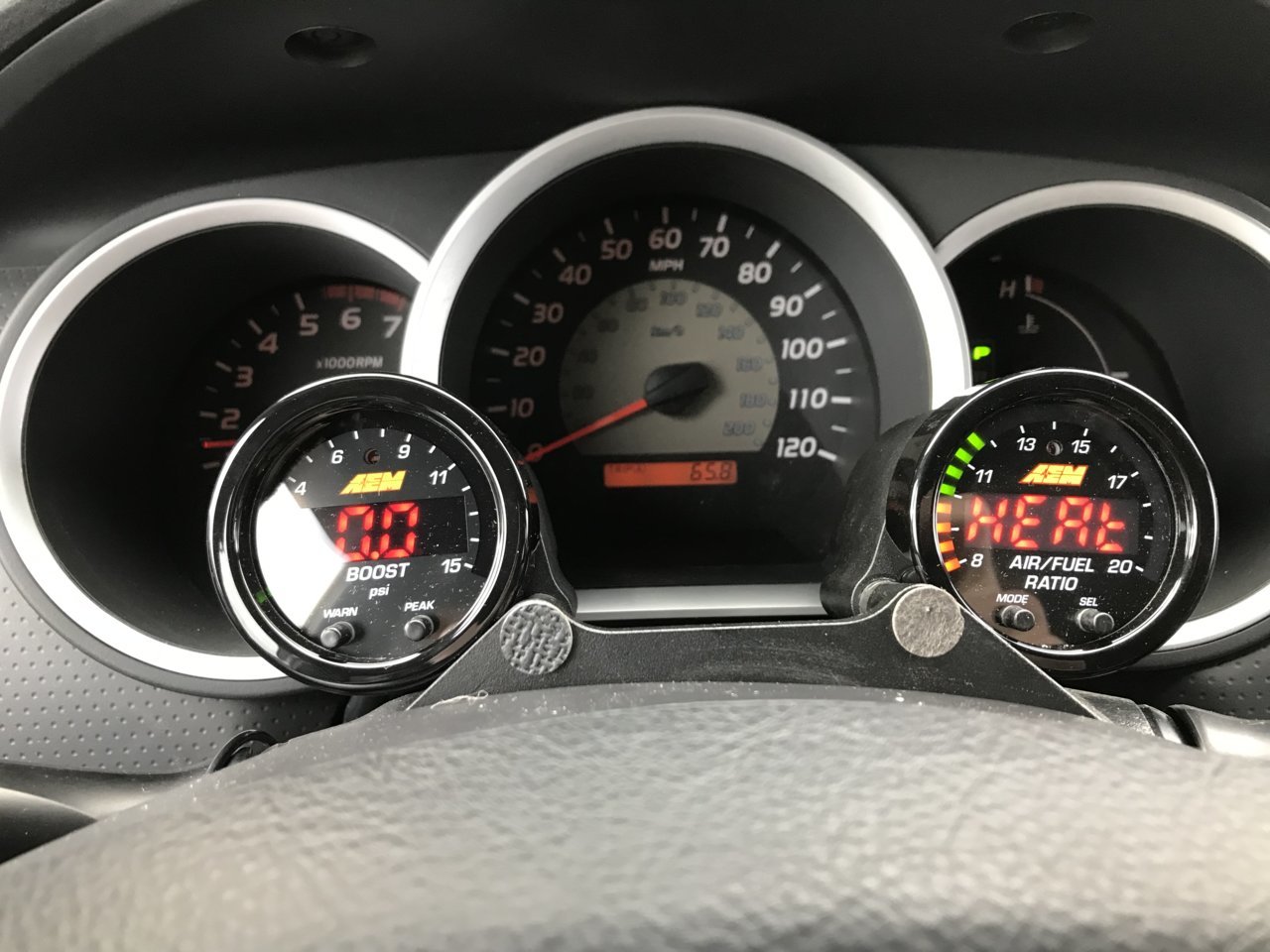

    I’m running AEM X-series 0-15 psi. Downside is there is no vacuum gauge with it, just boost.

    AEM X-Series gauges are top noth quality. You cannot go wrong and they are priced moderately for the value they have. I use the AFR gauge, but if I had to do it all over again I would switch out my Innovate boost gauge to the AEM.

    AEM X-series
    You WILL have to modify the cravenspeed gauge mount and add a little spacer AND extend the two thread pieces for these to work/fit. If you’re going with the x-series, check out my build thread on a recent page. I have pics posted of how I extended them.
