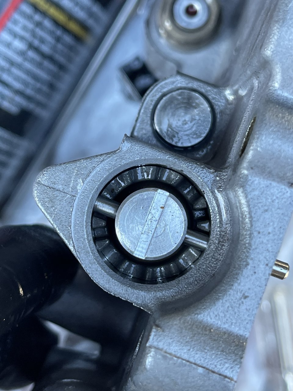

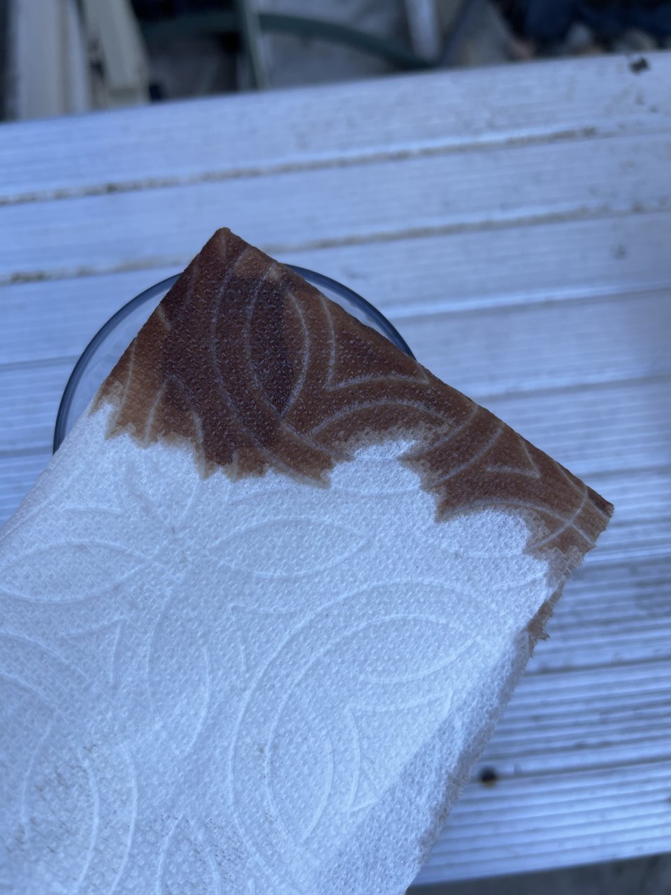

    Ah good to know I’ll have to request some. Trans fluid is pretty dark so want to get a read.

    That's the original WS correct?
    That's pretty standard color for WS ATF of that mileage. That's what mine looked like around that mileage, and since you wheel and have all that extra weight that's especially standard colored stuff there. Do your valve body, clean it up real good while you're in there from all of its dirt that is deposited on the metal of it and then do a tranny service 5,000 miles from then. That'll get you back to pretty darn clean.

    Sounds good. Good to hear. I expected it to be pretty dark. Was more worried about the trans hitting 300+ over summer. I’ve been cleaning wind the valve body as I pull it apart and planned to do another. Good to know on 5000. I was thinking sooner than that but that’s even better give it time to worn through.
    move been wanting to try the spicy trans tune but was waiting to tackle this first.
