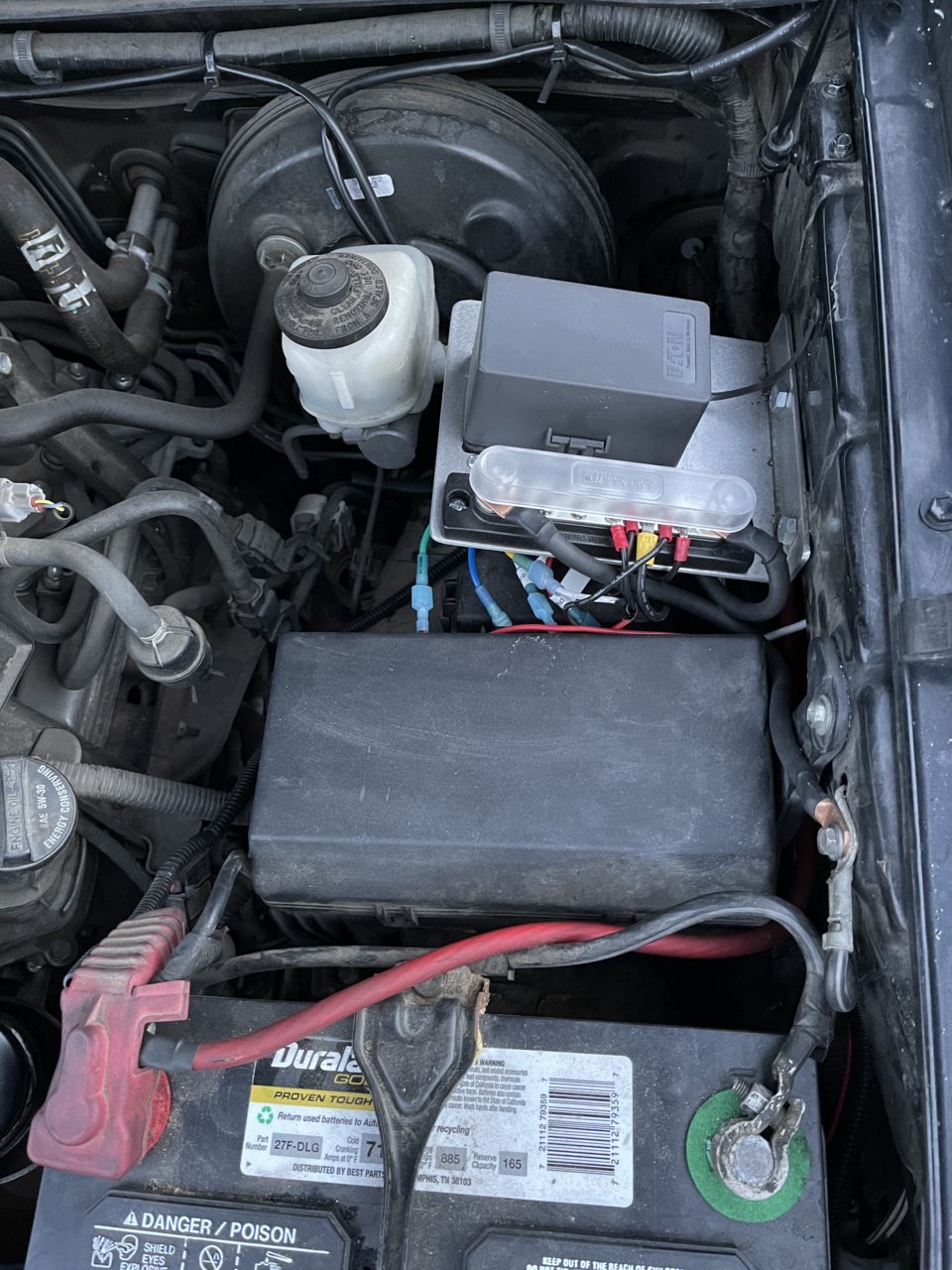

    Hey fellas I’ll be joining the SC crew soon. I’m not doing the install, having two little girls makes finding time like that tough, @Murphinator has been huge in helping me with all my questions, but have one more. Here’s a shot of my engine, the aux panel is where the reservoir is going to go.
    I found this pic in the forums
    But I don’t know how easy it would be to move the reservoir or if I should just move my panel. Super charg rook here, so any info would help.

    If you slot the mounting holes on your panel and rearrange your wiring a little, you may be able to shift the panel closer to the fuse box. Doing that may provide enough room for the coolant reservoir.
    Sorry to throw another wrench in there, but you might want to consider installing a catch can with your supercharger. And if you do install a catch can, you'll probably want to find underhood space for it too.

    I had the same problem, we cut the mounts off the I/C and turned around, mounted the tank on the pass side fender instead

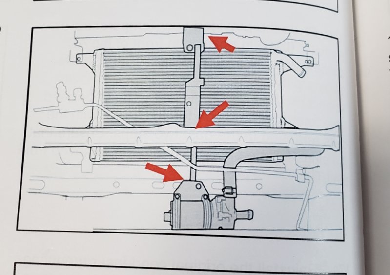

    The intercooler mounts using the ac condenser supports. It's sandwiched behind the hood/latch frame and in front of the condenser. Instead of cutting the mounts, I think it was easier to flip the intercooler water pump up front 180°. You'll see when you get there. That will allow you access the lines to route the reservoir on the passenger side. Here's a picture of how magnuson recommends it set up
