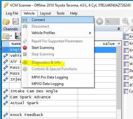

    HPTuners allows you to check your readiness monitors in the VCM Scanner.

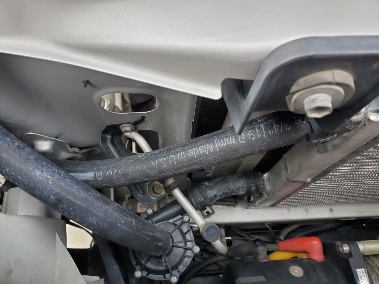

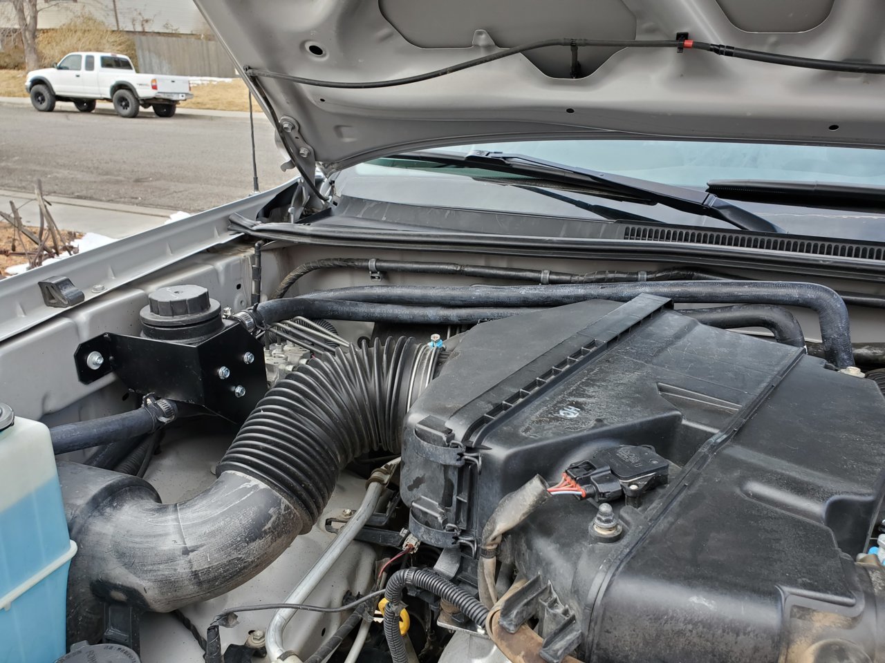

    TVH475
    TVH475 Well-Known Member
    Dec 18, 2018
    #276220
    325
    Montrose CO
    I'll snap some pics today, it wasn't bad to do at all
  6. Jan 20, 2021 at 9:53 AM
    nudavinci64
    nudavinci64 Robert @ Holy Horsepower
    Nov 14, 2013
    #116533
    10,146
    Robert
    San Mateo/Cayucos, CA
    13 S/C TRD OffRoad 4x4
    Boosted Money Pit....
    smog readiness right? any link or where to check that? I have always checked with my other scanner but HP might be better. I think my truck always says not ready but no codes.
  7. Jan 20, 2021 at 10:06 AM
    TVH475
    Dec 18, 2018
    #276220
    325
    Montrose CO
    Kinda hard to get a good picture without taking the grill off

  10. Jan 20, 2021 at 12:02 PM
    Mista_G
    Mista_G Well-Known Member
    Jan 20, 2015
    #146796
    1,064
    Costa Mesa, CA
    '13 DCLB 4x4
    Kings F/R 2.5" EXT w/700lb springs, JD Fab UCA’s w/ Lower Pivot Kit, Icon Progressive AAL (with TSB and overload in), CB drop, 285/75-17 nitto ridge grapplers, SCS Deep Dish Ray Dimes, Snugtop Rebel Shell, Prinsu Toprac, Gibson SS Catback Exhaust, ATH front /rear steel bumpers, CVT awning, Airflow snorkel, @ Shmellmopwho sliders, SC w/ @justdsm HPtune, 3° Cam Gears @mightytacoman, 2.8 smooth flow pulley, StopTech BBK
    Thanks dude. Looks like you have a little custom bracket to attach the rezi. I’ll probably just pull my tray and take a look once it’s all installed. Was maybe thinking of moving it to behind the rear seats anyway as I plan to throw an aux battery in there as well. Appreciate the photos though.
    TVH475[QUOTED] likes this.
  11. Jan 20, 2021 at 12:15 PM
    JustDSM
    JustDSM Oderint Dum Metuant
    Jan 16, 2015
    #146525
    3,302
    Justin
    Ogden, UT
    Yes. It will tell you which OBD2 Monitors are supported with the application, which are complete and which are not. It will also read your OBD2 codes as well as freezeframe data.
    Open VCM Scanner. Then go here:
