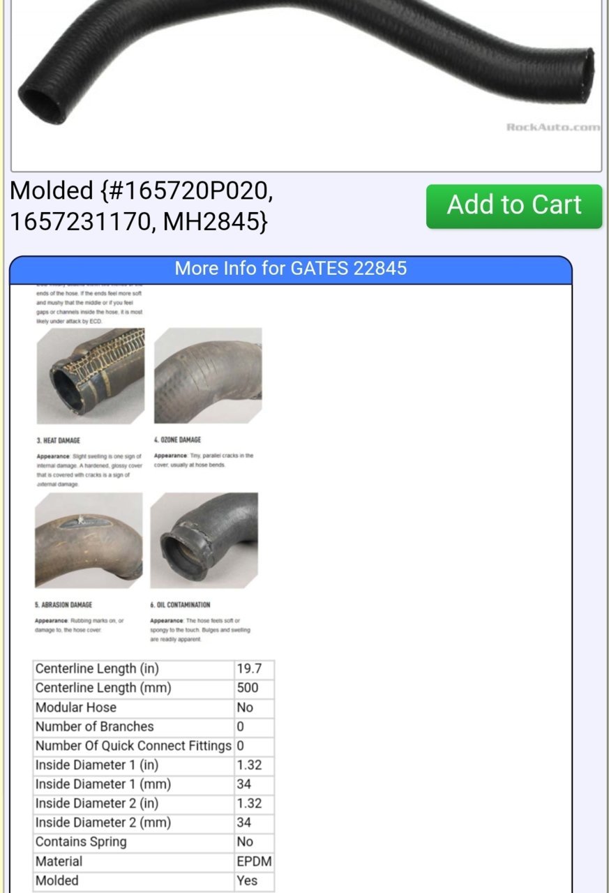

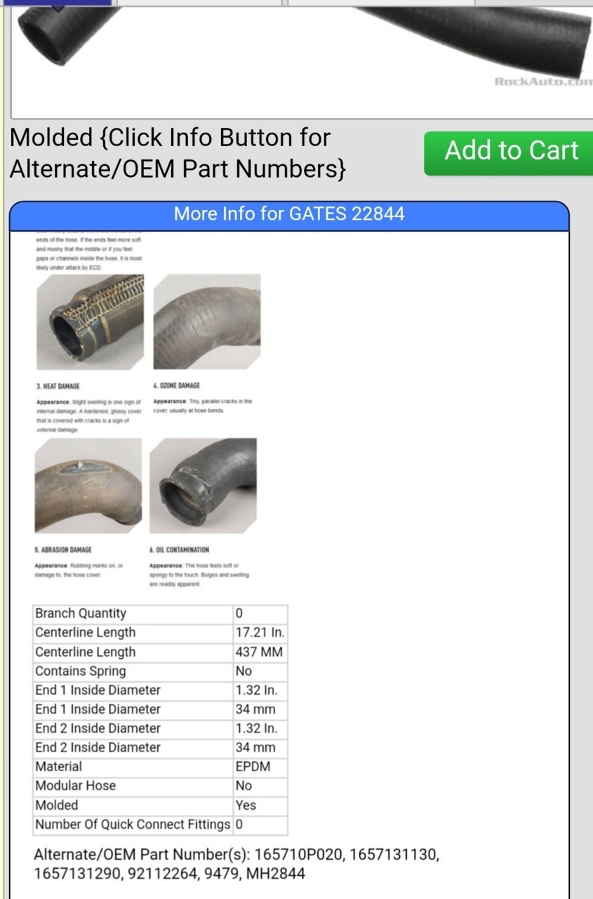

    Does anyone know the OE radiator hose sizes? I can't find it, but then again I haven't searched too hard for it either.

    Don't you have your deo fan kit? Just measure the hose adapter. It might even say on the side of it.
    EDIT: should be 33mm or 1 5/16"
    Lower

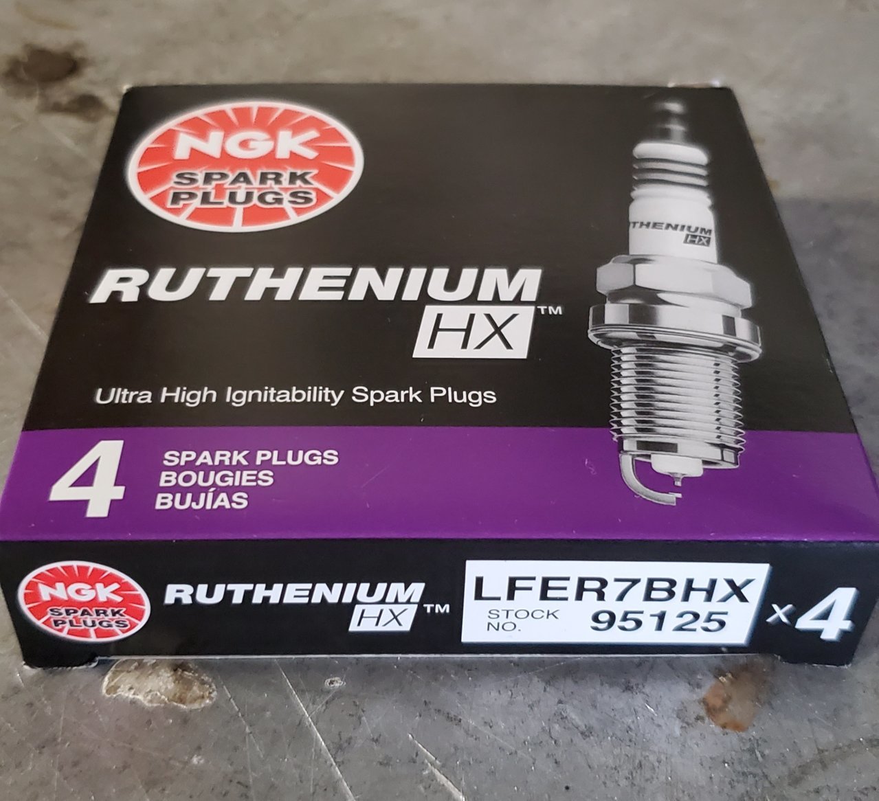

    I was wondering if there was any new info on the R-something spark plugs that someone tried out new for our trucks from NGK. I think they were the VW plugs?? I called Napa and they have a few in stock, could get more. Gotta do plugs soon, got roughly 24k on the SC since install.

    @Skootter14 welcome back! Here are the plugs. A few of us are waiting on the re-release of the hi-performance ign coils from RIPP superchargers to pair with these plugs.

    I assume there have been no problems for those that decided to test them out back in Jun/Jul of 2020? I could stick with the plugs that came with the sc but figured if these help burn more fuel and all that with no negaives observed it may not be a bad alternative.

    The early adopters have reported no problems and have claimed an improvement in fuel economy. I'm waiting to do these Ruthenium plugs and RIPP coils at the same time. There was a hiccup in the RIPP coils original design for the 1GRFE Tacoma which made them go back to the drawing board.

    I have been running those plugs and the rip coils with no issues. I am using the 3rd gen taco coil packs which are a bit longer than they are supposed to be, but in terms of function they are working fine.
