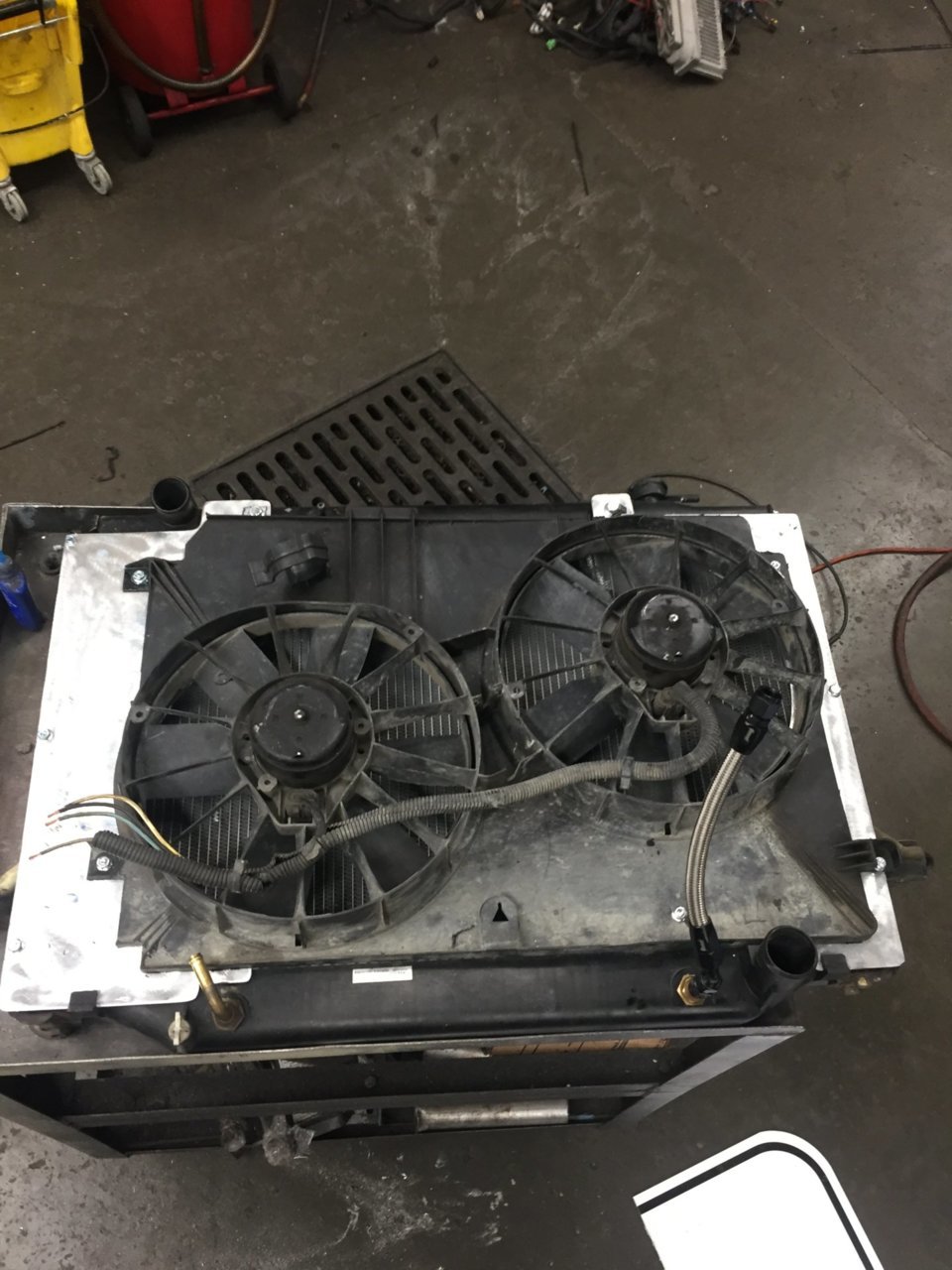

    If you do make a custom shroud for it please let me know what you do, as I am still some time away from install and if it's easy enough I may do it myself. I am not comfortable with one stud and nut per bracket holding them at the drive motor.

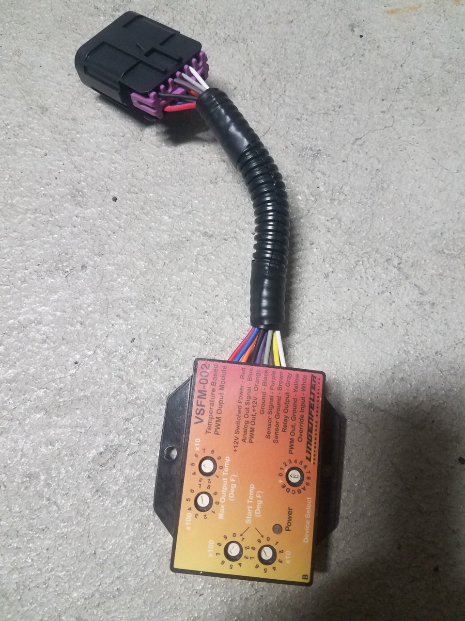

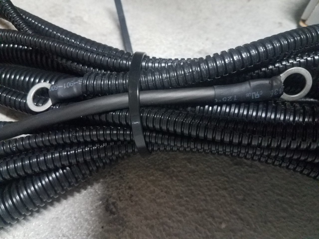

    @Murphinator
    "Hey, moving forward, I have some improvements I'd like to give you.
    - May I suggest wrapping the Lingenfelter box wiring with some of that 3/8's looming to protect the exposed wiring
    - Giving buyers the option to eliminate the 4 additional wires which come out of the Lingenfelter box. To eliminate so many wires coming out of the plug. Pictures below:
    - I also suggest your wire terminator guy remove the plastic caps from the bolt on terminals and heat shrink them for a more professional look. (Looking back at this comment here, it's not just more for a protective look, it's to protect the thin strand thick gauge wiring from being pulled individually when handling and over time as well to seamlessly make the wiring and the ring terminals become one, so it's sort of a win- win situation when using heat shrink over plastic shield. Given that the wiring is already pre terminated and installed, you can take a razor blade to cut the plastic shield that goes over the bulk of the wiring then stretch the appropriate heat shrink which will insulate the head and wiring of the terminal using some needle nose pliers or flat head screwdrivers until it fits over the ring terminals then heat as usual until it shrinks tightly over the area)
    - The fan mounting brackets strike the fan while the fan is at a standstill, I had to separate them by heating the fan mounting tangs and pulling away a little bit. This should be addressed prior to receiving the new setup.
    All of these are things that I would suggest addressing before your next release of the E-Fan setup. I know we were the first iteration, and hopefully this feedback is helpful to you."
    As I stated, they are very small improvements and not many which is impressive in itself considering it was the first round of sold kits, but will give the kit a better overall long term functionality, protective, and polished look.

    @Murphinator i just installed the RPM in mine with 2.8 and Roush so nice not to have to trim the belt.
    kepe me posted on the shroud if I can get around that’s the route I want to take. I planned to do the efan along with HPS hoses as well. Also want to upgrade trans cooler and debating on the mishi 160 t stat.

    I am going to update the photos so you can see what I am referring to regarding the looming and the fan to bracket gaps, though that stuff is fairly self explanatory.

    Nice some pictures would be helpful.
    need to see how I can make a metal shroud to mount the existing one. Ditch those arms completely
    this is a setup my brother setup on his 80 series when he did a LS swap using an engine from a camero. 02 I think so different but similar deal and got me thinking.
