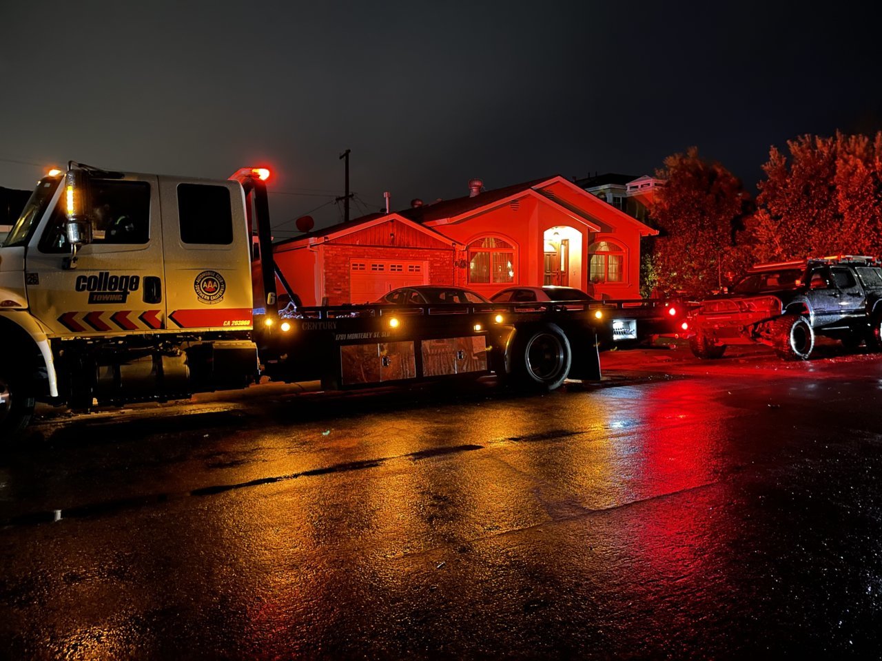

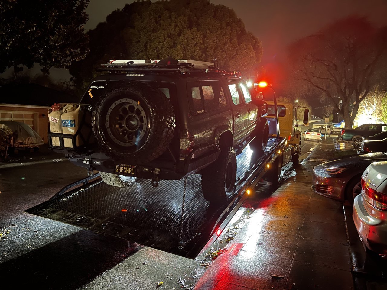

    Update: Trucks back home
    When loading it up in neutral onto the tow truck the rear wouldn’t move that thing is fu!¥ked! Almost positive that’s it.

    @nudavinci64 I'm not well versed enough with 3rd members/rear ends especially with the variations between the Gen2 and Gen2.5 and OR and Sport models......
    But I am very curious about what could have caused your rear diff to seize up. I would think the "spicy" trans tune is purely electronic and changed values that would affect only the AT. Even if it caused the AT to shift extremely hard or slip while shifting.... I'm trying to understand how impact to the AT would transfer down the driveshaft to the rear diff and cause all those gears to seize/bind.
    So looking at the rear end individually..... do you have an aftermarket rear locker? Did it happen to just give up the ghost coincidentally right after the HP Tuner spicy trans tune?
    I'm empathetic to your situation and glad that you got it towed home safely. Cayucos to San Mateo isn't a walk in the park with all the traffic between the South Bay and Pismo.
    Looking forward to your forensic work on this blown rear differential. If you're in a bind and need a hand, I can cruise by. Please keep us posted.

    Thanks, today was just one of those C'Mon its not 2020 anymore. Whatever this is (lets call it blown rear), AAA tow just outside of the free 200-mile range which generated extra cost, Then we almost ended up getting another tow when a meta bar of some sort flew up out of the road and hit my brother's car. Not to mention the headlights turned off randomly going down a hill on 101 (luckily came back) but WTF really. Let me add a photo
    Honestly, as @JustDSM noted it the same one several guys are running and it drives out of the house and up just fine. I think it is a lot of confidence all wrapped up into one. My other brother who has the shop kept saying check the transmission since work was just done but it gave no indicator on the 300-400 miles prior it was having issues besides the harder shifts.
    When I pulled out to get onto the road I gave it some gas and well you know some SPICY gas on the pedal and the rear did slip and chirp some tires. Running big 35's, the heavy truck I think the rear just said F that it kind of chugged it's away over to the side, and with some very slight movements to get it more off the road the rear just started to get worse. Likely if it is the gears that broke eventually got jammed into a fat mess. When we pulled it on the truck the rear was not having it and would just buckle or get stuck as something was jamming it from moving. when we lowered it off it had a minor ping but we were able to roll it off likely the reverse was more open than forward. Tring to put it into any gear started to bind real bad in the rear and could have messed up the trans so did not try to go anyfurther. The main thing was to be able to get it on the flat bed and out of the road.
    Really bad timing as I just go the email that my Super Pacific X1 will be ready sometime in February so I have out a month to figure this out and possibly fix it.

    Starting to make more sense.. i do recall hearing about broken diffs back when I lived life a 1/4 mile at a time. High HP + globs of tractions + minimal flex + wheelie bars = sumthin' probably gonna break. Usually axles, diffs or transmissions or whatever was the weakest link....
    Busted diffs usually meant internal gears with some teeth sheared off. Those metal chunks would definitely constrict movement of those gears.
    My hypothesis... your truck has 300tq+ with the blower. Spicy tune making shifts firm/harsh/grab instantly (gear slamming on a MT). The added weight over your rear axle = major traction aid to the (not sticky) 35s but which has plenty of sidewall to flex.
    The stress/twist from that torque and shock caused the weakest link to fail. In this case, differential gears?
    Sherlock Holmes hat off......
