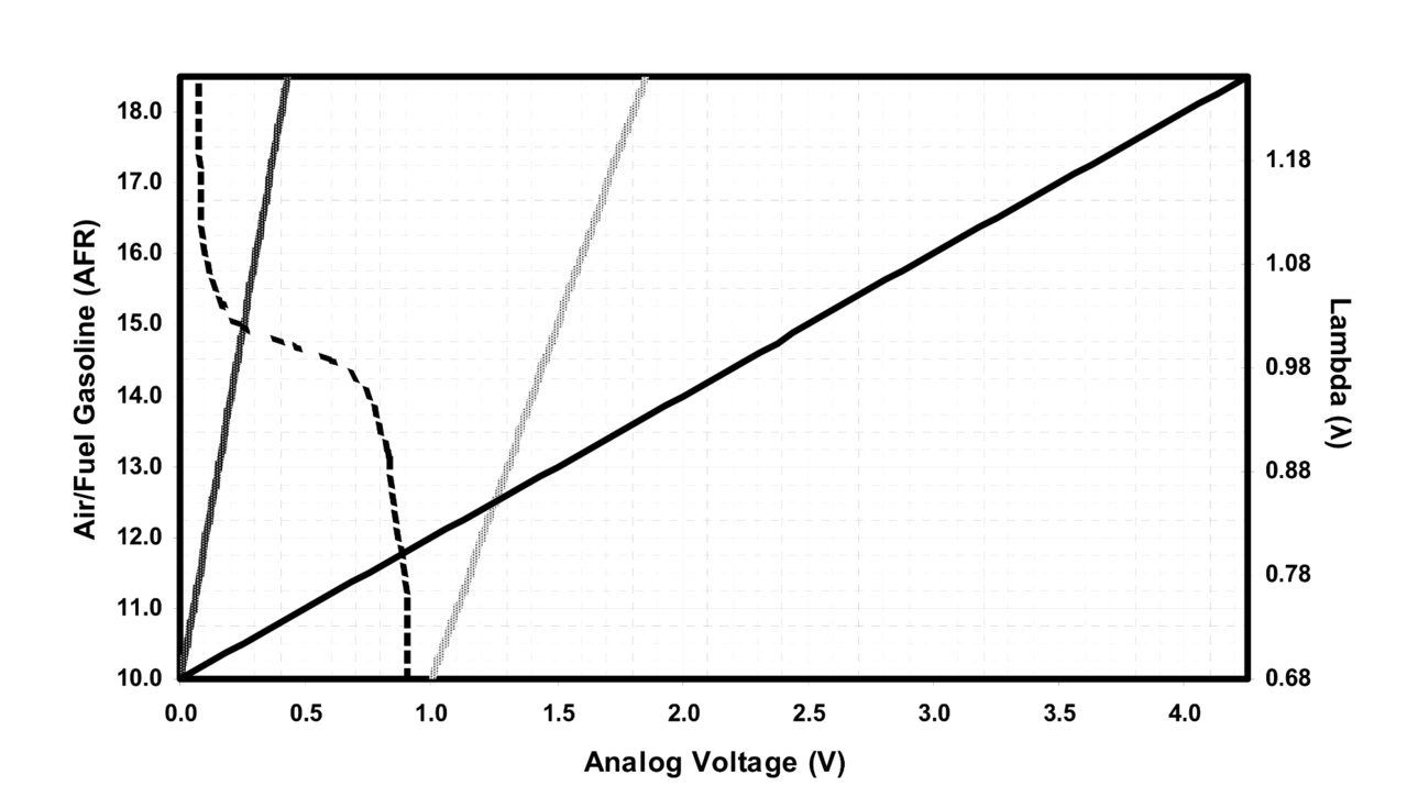

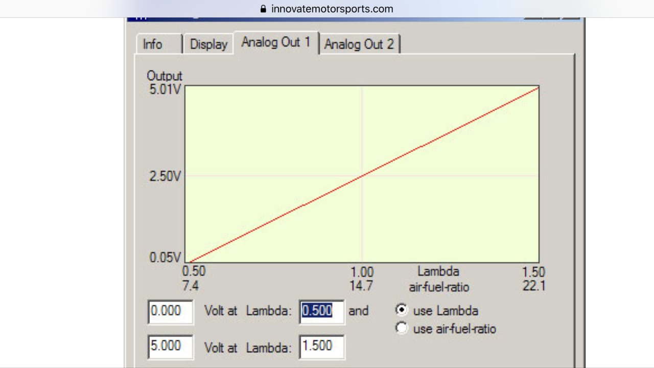

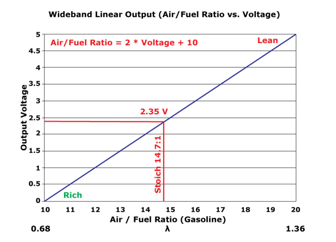

    Some examples from the instruction manuals.
    Innovate
    PLX
    AEM

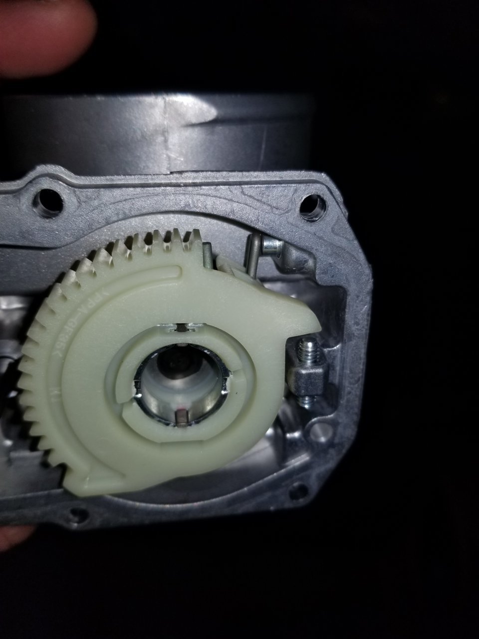

    What about for f/i? Bought the truck with all mods. Runs a little leen according to my a/f guage. Went to clean the TB and found out its a 76mm. I picked up a stock 65mm tb and while it helped my numbers come down on the guage im experiencing other issues like a bank 2 sensor 1 02 code (2241). Also received some hesitation in and out during spirited acceleration. And I'm not sure on this but I think I'm hearing a slight spark knock (real quiet) right at 2k rpms. Anyway I'm changing out the plugs, gonna try ngk and I'm debating on putting the 76mm back in. It's got mk3 stg1 pulley and program but stg2 exhaust. Should I try and turn this screw? One turn, 1/2 a turn?:notsure:

    Was there a gasket or silicone on the 76mm TB, when you removed it from the adapter? If not, that is why it was lean.
    Silicone it up, then do the turns like they have shown.
    N/Es06[QUOTED] and Roostfactor like this.
