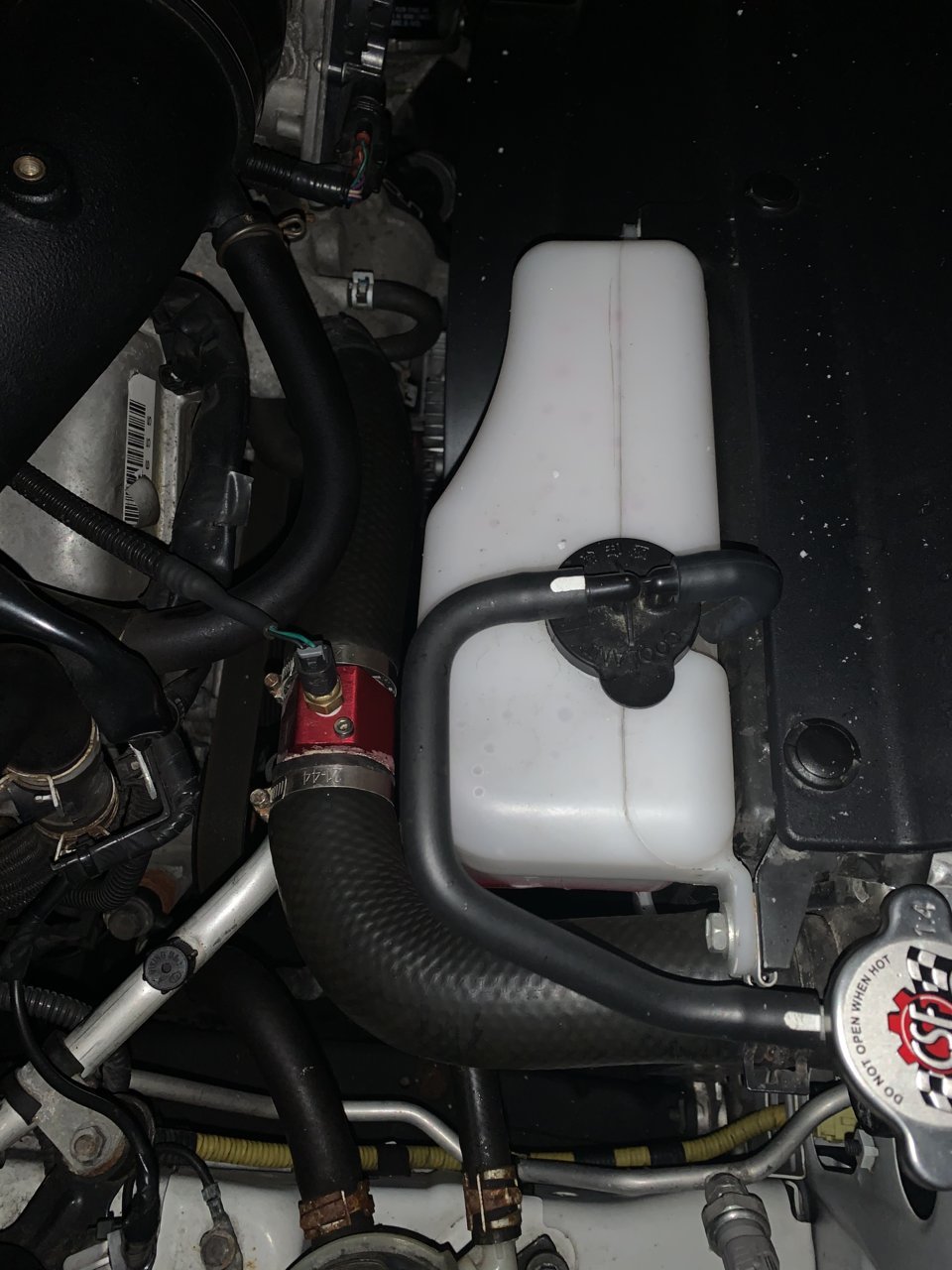

    Well I finally received my HPS hoses.
    Now I'm wondering if I want to cut the upper silicone hose in half or cut the OE hose in half for the upper hose temperature sensor adapter.
    Do you still have secondary air hooked up? What's your setup? I can't remember.

    JuanitoBonito
    JuanitoBonito Que Pasa
    Dec 29, 2013
    #119422
    9,178
    Juan
    CHI-TOWN
    2024 Raptor
    I was thinking the same on my upper hose. I did it to my oem top rubber hose for my sensor. Didn’t think about it until after I ordered.....

    How do you think it’ll cut? You think it’ll easy...fray etc. if I know it’ll cut nice and east, I’ll cut this one too like I did my oem. I’ll go snap a quick pic to show you my set up now.

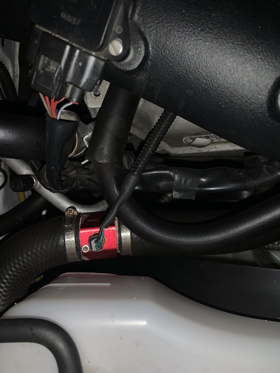

    B01F72EA-48E9-4980-801F-F957038F482F.jpg D1C6442D-9348-458A-8524-59A81EEB3869.jpg

    How far does the sensor space the hose apart, are you doing one cut or removing a small section?

    Shortly after the bend. Noted. Thanks for the photos bro.
    Also, it looks like those clamps leak, exactly like I suspected when I was looking at them. I bought some spring loaded clamps from Toyota and hopefully they will fit just fine over the hose adaption ends. Worse comes to worse I'll have to use traditional large hold worm drives, but the ones supplied appear to have weaker sealing and holding power. Than traditional worm drives.
