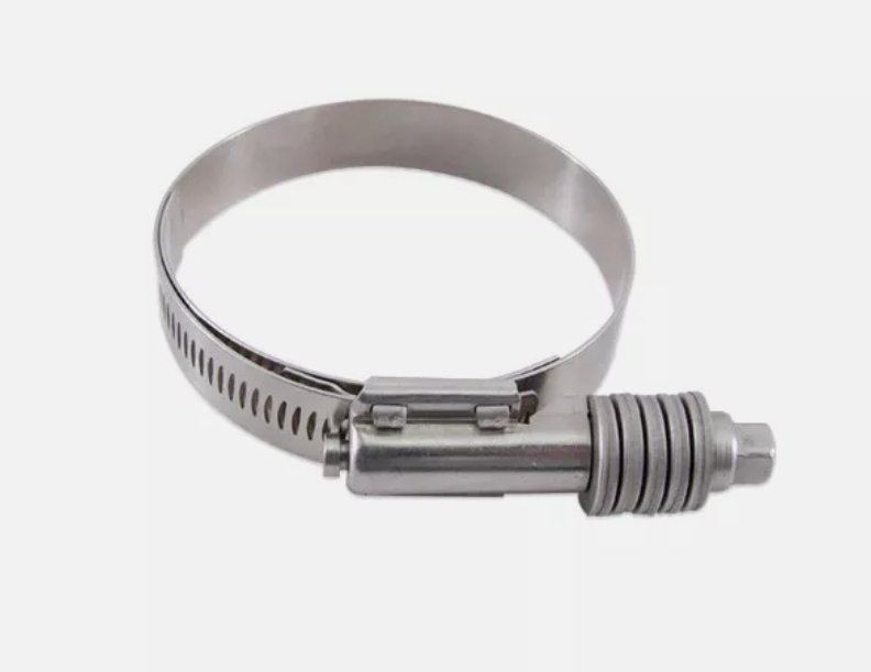

    Just another option. Nothing wrong with that I hope. But silicone hoses claim to seal better and outlast epdm rubber with "improved" liner clamps and constant tension. If anything, these can be tightened if blowing a hose were an issue but maybe there's other problems by then.

    Yeah silicone has its advantages for sure.
    There is a lot wrong with giving more options here. Just kidding. ;)
    More options is ALWAYS a good thing here. It's what led me to make this thread in the first place when the naysaying was initially VERY high on modification limits of this system. Look where we are now.

    Could always use the Gates heat shrink hose clamps....
    As long as you don't have to remove your hoses any time soon.

    Ahh yes, I've seen those before on Ford. The ones that leak like theres no tomorrow.
    I dig the way they look actually.
