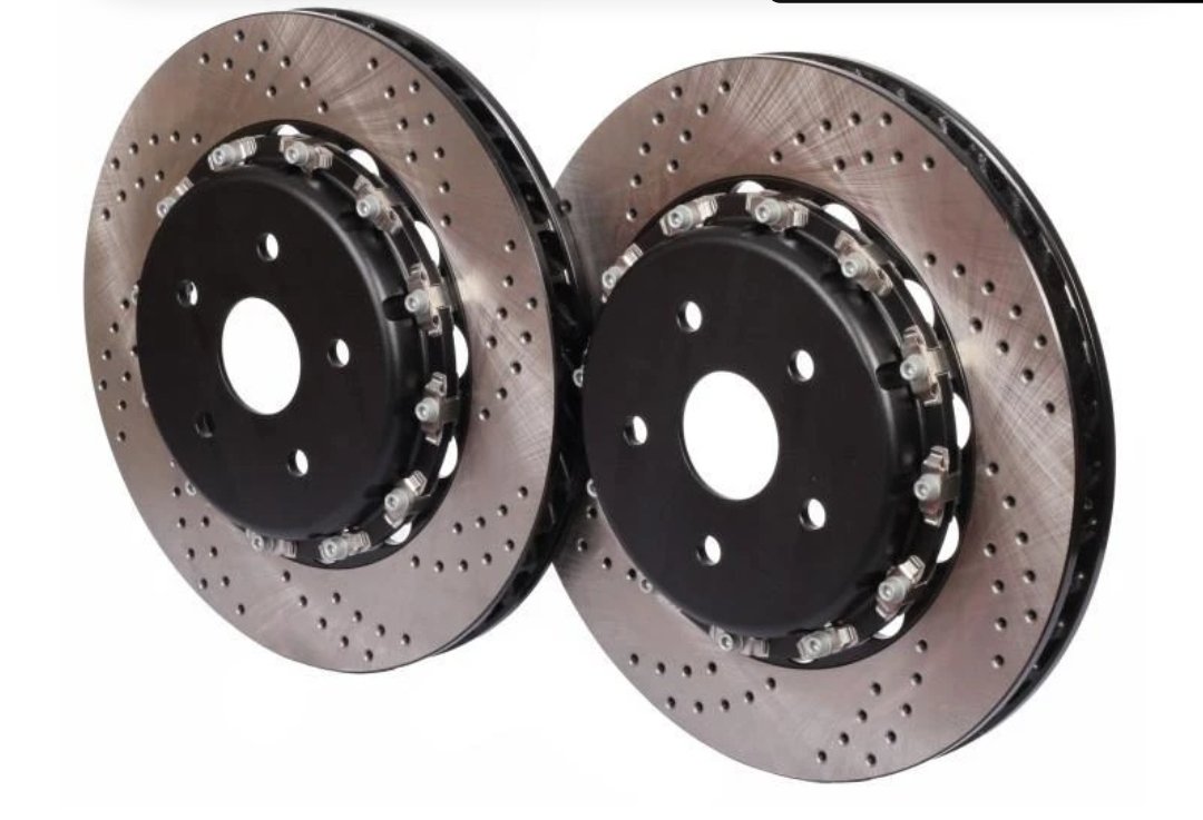

    I have been considering that. since we are rocking the same brakes have you found a 2 piece that swaps in? I have a set of DBA rotors I was going to use but if we can slot in some 2 pieces I would consider that. I thought about getting willwoods but the setups for the tacoma are the forged light versions not the Aero6 or Aero6-ds Yah overall the KM3's are smooth and solid just heavy.

    I was about to get some of the DBA's myself. :)
    I'm not aware of any 2pc stock size rotors for our application. Would be interested to hear if any were available however!

    Yeah those DBA4000 are really nice, I have been waiting to wear down the stoptech rotors I have first. @jamesepoop and I are running Wilwood Areo6-DS mated to 4runner rotors so looking basically for a replacement rotor for the 338mm TR4. I wonder if the offset would be different on the Wilwood version by much. I noticed recently that my rotors do not go to the top of my pads and will need to be shimmed and can possibly run 340-342mm rotors no problem but that's an expensive lets test it out option.
    If we could run these rotors which are for the Superlite that would-be killer.
    https://www.wilwood.com/BrakeKits/B...ear=2008&make=Toyota&model=4Runner&option=All

    Does anyone know if any diagrams like this for Tacoma/4runners for clearances exist? This should help identify if some of the 2 pieces would work or not.

    nice! Yah the GX (Prado) uses the same or similar to the T4R but there are 2 versions but these look like the right ones. There is a 28mm and 32mm version. if these are the same as the GX setups then it likely it should work. Pricey but yes likely yes. I had been doing some searches but had not seen these.

    @jamesepoop and I are both running Wilwood Aero6-DS that was set up on a config to work with T4R rotors so looks like a perfect fit. Def great find.

    The SOS Performance 340mm BBK with the Stoptech ST-60 caliper also uses the 340mm rotor found on the newer T4R and GX.
    SOS use to have the option to use Stoptech Aerofloat 2 pc rotors in their kits. In fact, they list the rotor ring still. Maybe SOS has the rotor hats...and if they do, this aerorotor 2pc rotor *should* be a direct swap onto your wilwoods, right?
    https://sosperformance.com/products/stoptech-aerorotor-drilled-ring-with-zinc-plating
    (Sorry, i noticed its still an iron alloy setup. Probably no weight reduction)

    Even the CEIKA are IRON but that is the ring. The hat you get the weight savings. I think it was 3-4lbs from OEM on some comments. the newer T4R and GX is 338 so they likely are rocking 340 which is slightly bigger then the OEM size but based on my setup i need to shim or get 340 as its not catching all of the pad on top.
