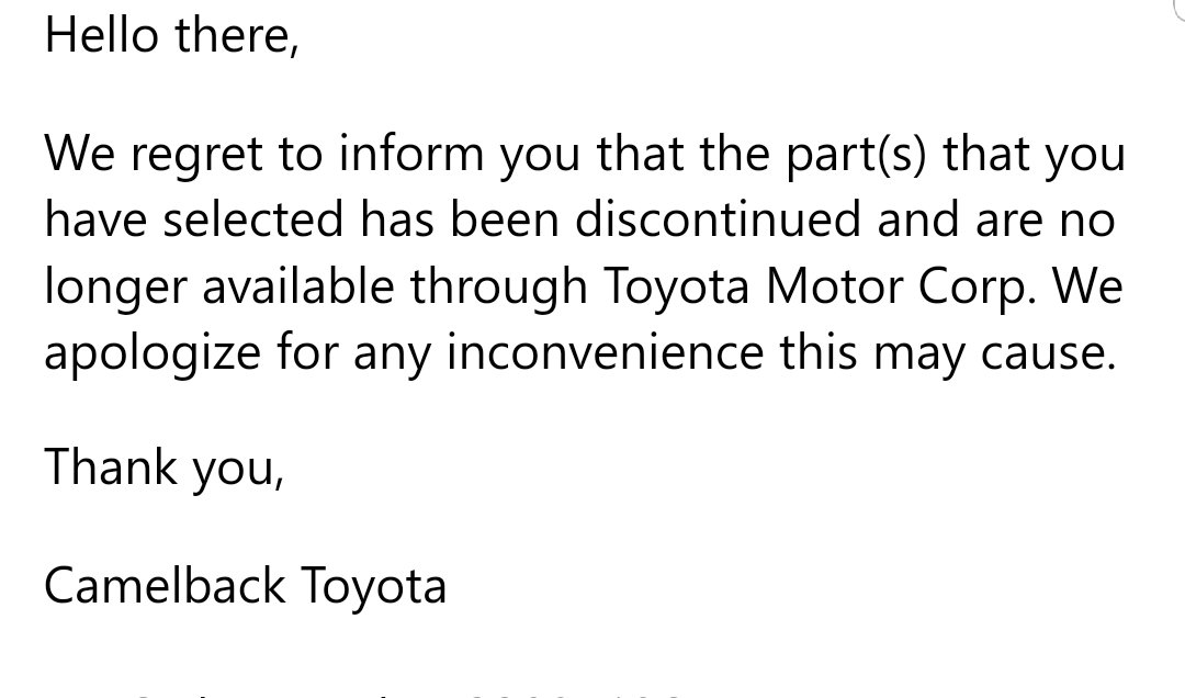

    I recall someone posting the same thing, back when the S/C group buy was going on. Shows available but then they tell you it’s not available. Bummer!

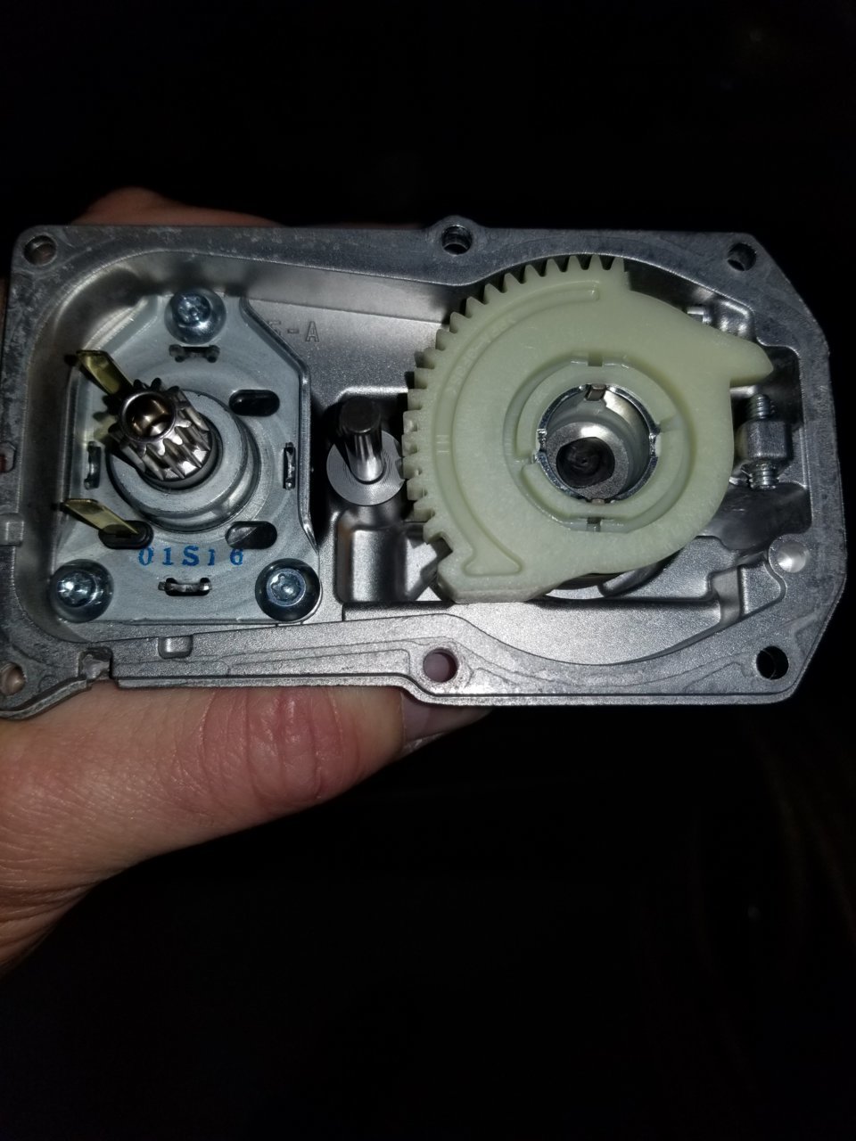

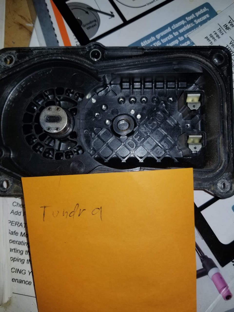

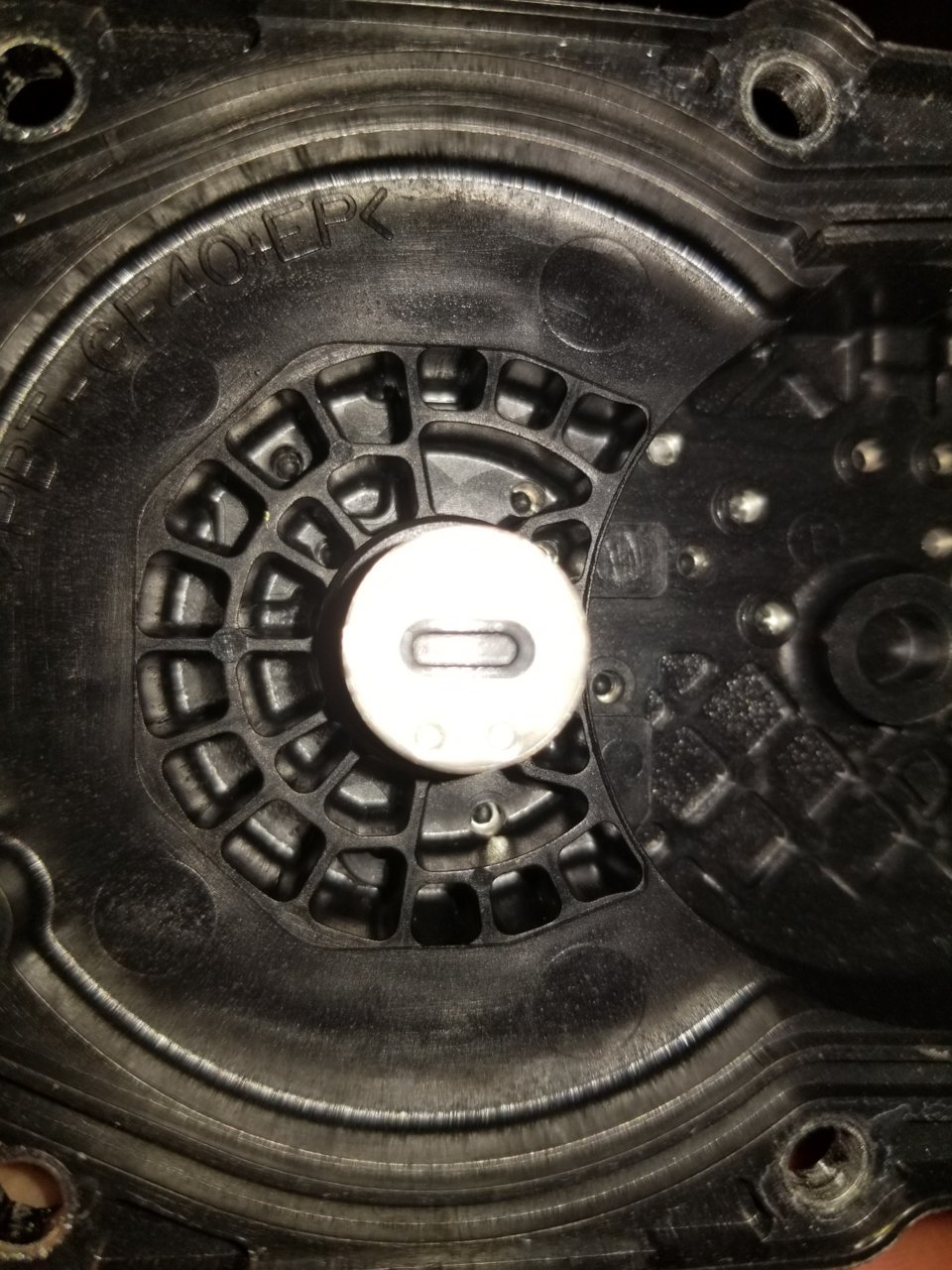

    You can try changing the cover plate with your 65mm. I did when I was doing some testing and it worked fine on the 76mm tb. The cover plate transfers throttle position to the ecu via a hall effect sensor attached to the tb butterfly gear.
    I just pop riveted my cover plate back on but @loginfailed had a great idea and tapped threads in his tb and used screws.
    Let us know if you try this and how it works out. I'm curious if this is a solid fix. There really isnt that much to these tb's.20180202_131357.jpg 20180201_153354.jpgHere is the sensor on the cap.20180201_153243.jpg The sensor on the cap fits into the recess on this gear. This is the tb butterfly gear. There is a center gear (removed in this pic) that connects the motor to the butterfly.

    I have seen that a number of times with Camelback and others.
    So far had good luck ordering from Toyota of dallas
    Www trdparts4u.com

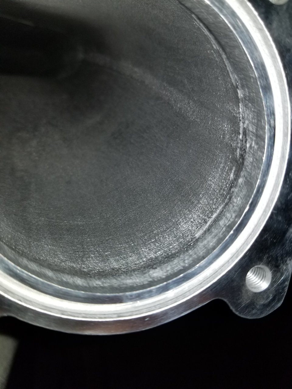

    I have thought about removing the stock supercharger inlet and welding a flange near the 180° bend. The throttle body would mount to the flange.20170525_215806.jpg sc inlet after porting.
    20170509_123801.jpg Before porting. Notice how the inlet gets larger right after the flange.
