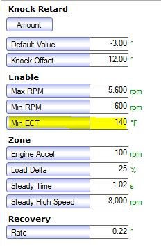

    Keep in mind that the knock control doesn't activate until coolant temps are above 140deg F.
