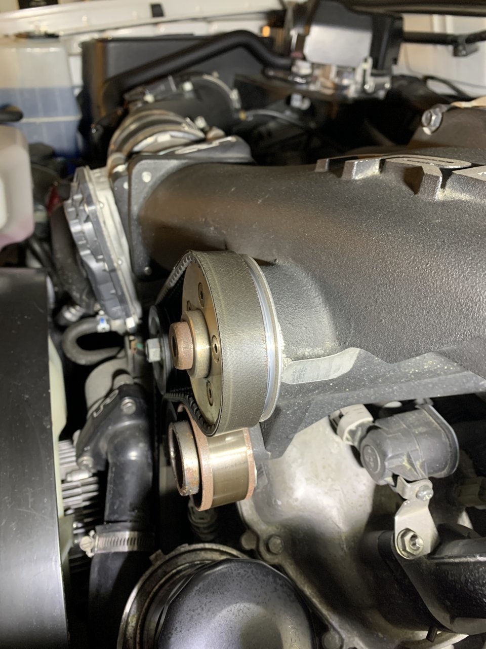

    What is the size bolt used to loosen the belt tensioner??? Just took the truck to the dealer for an oil change and got it washed. I was wiping out the engine bay afterwards in the parking lot and saw my s/c belt is mysteriously off the pulley by one rib

    Awesome.....and don’t laugh, I’ve never messed with the belt before. I know it’s easy but once on the tensioner (looking from the top down) am I moving it left or right to break tension to then snug the belt back on the rib
    pic to follow, just got home

    I usually get it with my tensioner tool from the drivers coming from the bottom. You push down on the handle which should rotate the tensioner clockwise (from front of truck) and you can slip the belt back on.

    Thanks man. I was just trying to figure out how I was gonna do this. This should help. I’ve never had this issue. I don’t beat on this thing. And I’m under my hood quite often.

    Oh I have my fun. But it is babied at the end of the day. Fixed!! Thank for the help. I’m fully convinced this was done intentional. I’m always under my gods and am meticulous and observant. image.jpg

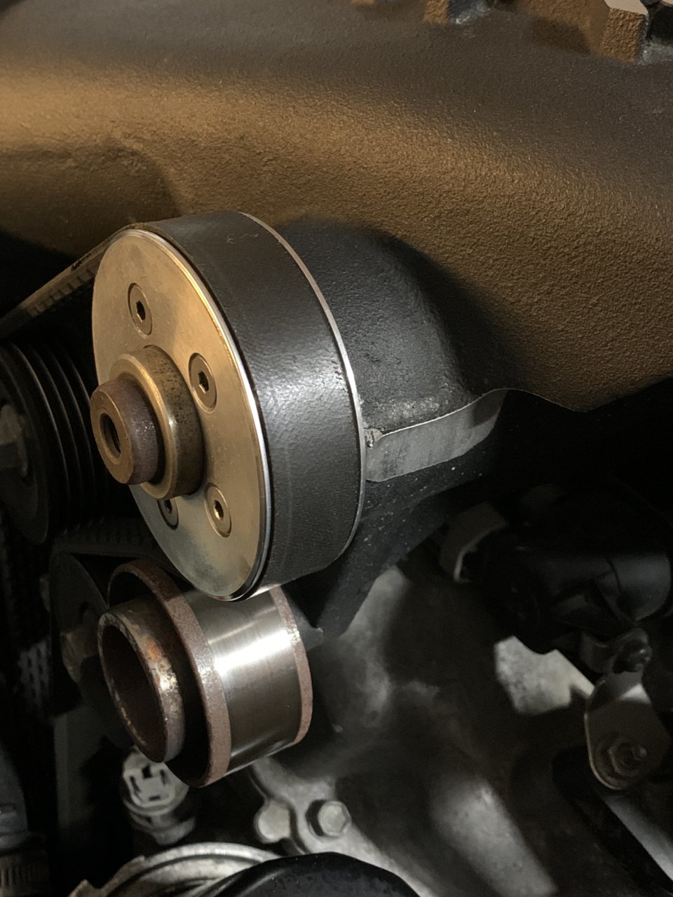

    @JuanitoBunito your hub appears to be on farther than mine. wonder if that played a part in the rib hop.

    I doubt it man. I’m under my hood constantly. I’ve never had any problems with this what so ever. A very reputable shop did the grinding and pulley install. I have complete faith in them. Plus I have the roosty pulley mod adding even more tension

    I was wondering the same thing.. Do you have any pictures from the passenger side looking down at the s/c pulley? I am curious what the belt looks like and if it is all lined up good. Mine is also pressed on just a scosche less than that like Jesse mentioned. I originally didn't press mine on far enough and it jumped off the other direction and broke the belt.
