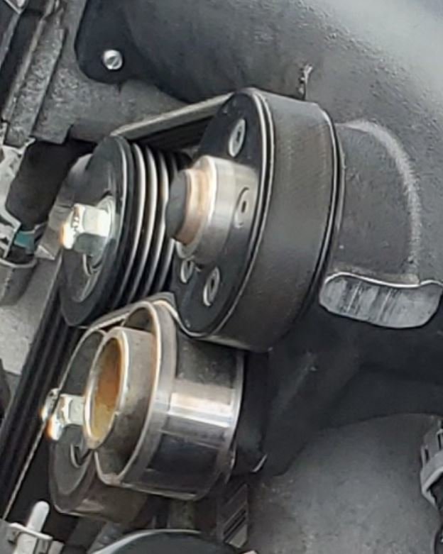

    I don’t......but can tomorrow at the fire house. I also forgot to mention to Jesse and you too that the shop had me go in the back to check my truck when they did this work for me. They showed me everything was lined up.....

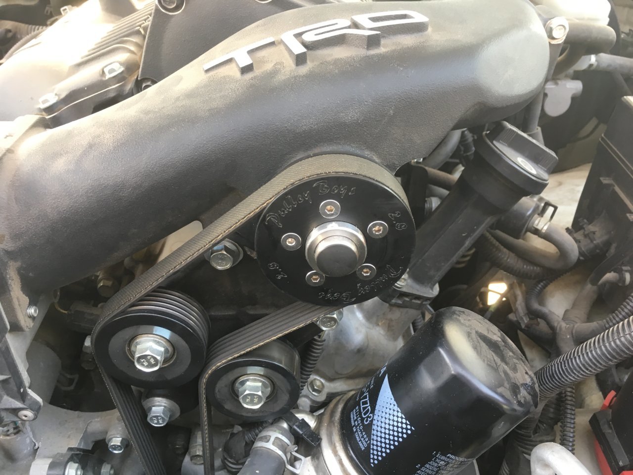

    Dood. Nobody at the dealer messed with your belt.
    I dunno man. That thing is pressed on there pretty deep. That belt you’re running isn’t helping anything either. Is that a gatorback? All of those cross cuts are just going to help it claw itself out of its grooves. Just like the lugs on the side of a good off road tire help you climb out of ruts. Fix the alignment and get the RPM belt. It’s the shizzle.
    Here’s mine:

    Time will tell I guess......let’s see if this happens again

    What makes me so suspicious is I was under my hood just yesterday to disconnect my battery. I didn’t leave from that point to when I went today for the oil change. I hate thinking that, I really do. This dealer here near my house are a bunch of shady cats......both the 3-4 salesmen I’ve dealt with and the counter guys in the service dept. we’ve caught them in a few lies regarding the Camry when they had it for a recall then again when they had it for a warranty issue.

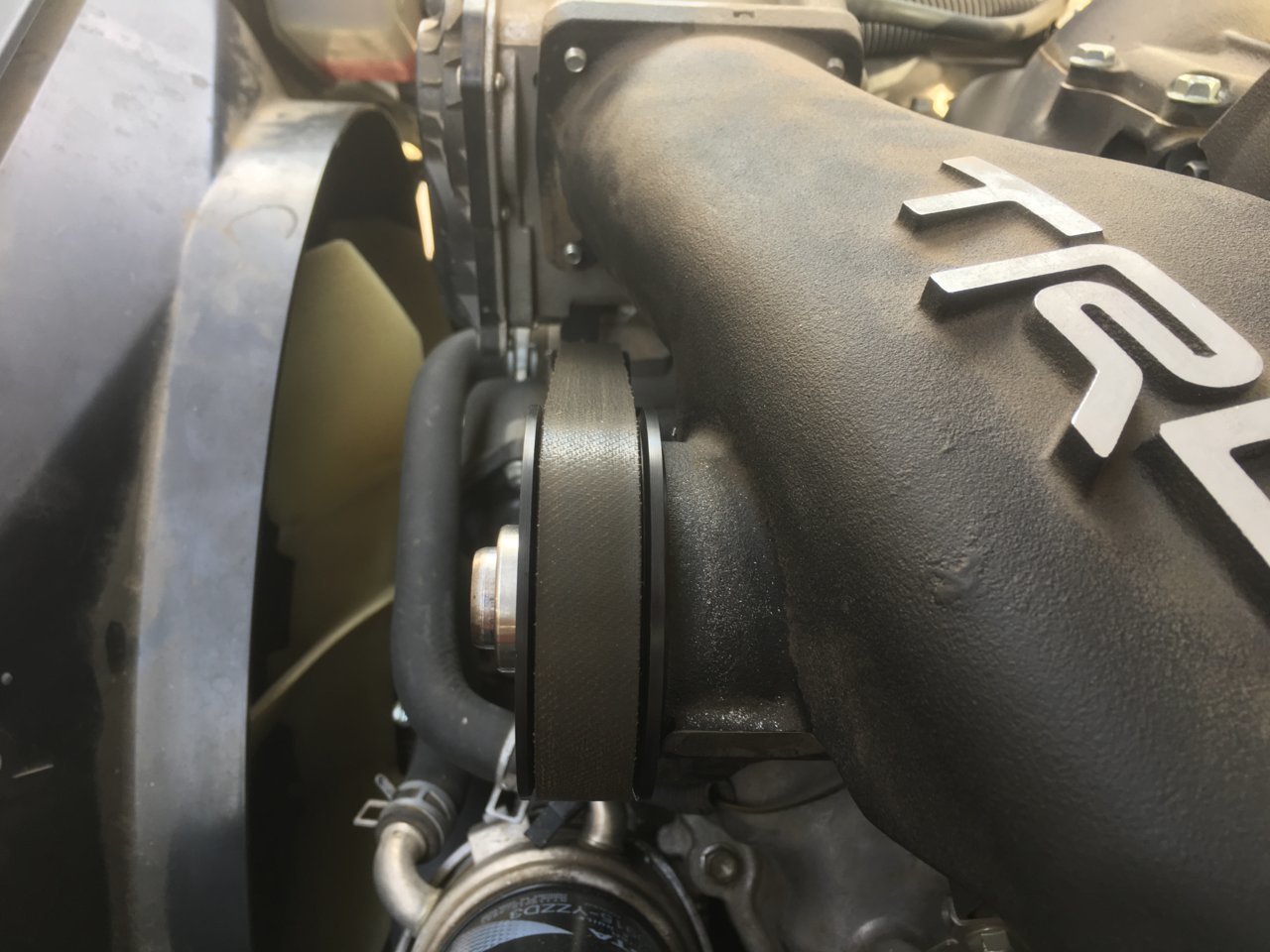

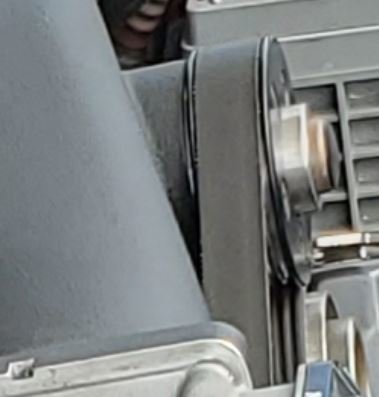

    Don't know your dealer, @JuanitoBunito, but have known my share of shady ones. Between that, the fact that you observed no belt trouble (for how many miles?) before taking it in, and, IMO, your pulley doesn't appear seated much differently than mine (or others pictured in this thread), I believe it's possible you were setup for failure. FWIW, here's what mine has looked like for almost two years and 14K miles...
