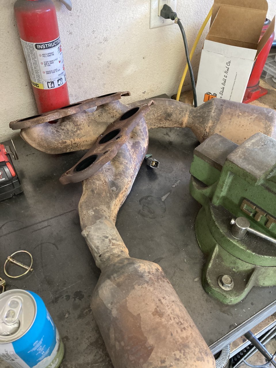

    7,205
    Robert
    San Antonio, TX or nearest race track
    06 Toyota 4Runner
