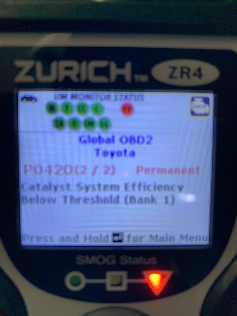

    So here is what I got......bad cat?

    If you're gonna put on long tubes then it won't matter here shortly. But if you wanna confirm sensor vs CAT, then switch sensors between Bank 1 and Bank 2 then after clearing the code and see if code repopulates on the same side or the opposite side.

    If you have the urd o2 sim. That is suppose to block the CELs for P0420 and P0430
    HPTuner does the same thing without needing the o2 sim

    Pretty sure the sims are only downstream. I would need to check the code, but I thought this was upstream. If in fact, 0420 and 0430 are downstream then this is just a waste of time. Once again, refer back to once you convert your truck for racing with HP and we can get this straightened out as well.
