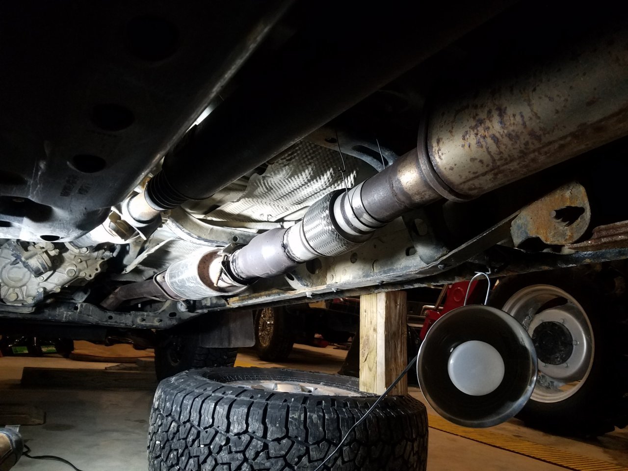

    20210206_214855.jpg Promised pics of exhaust.
    URD header and y pipe, 3" flex connector to 3" vibrant resonator, then a braided flex to Magnaflow cat to 22" magnaflow, and 45 degree angled out 45 degrees just past the axle. May swap out for 24" magnaflow. Little loud, not much drone.
    I haven't found an ideal 3" donut gasket for the flex coupler. Have one more to try.
    *Wrong order, fixed.
