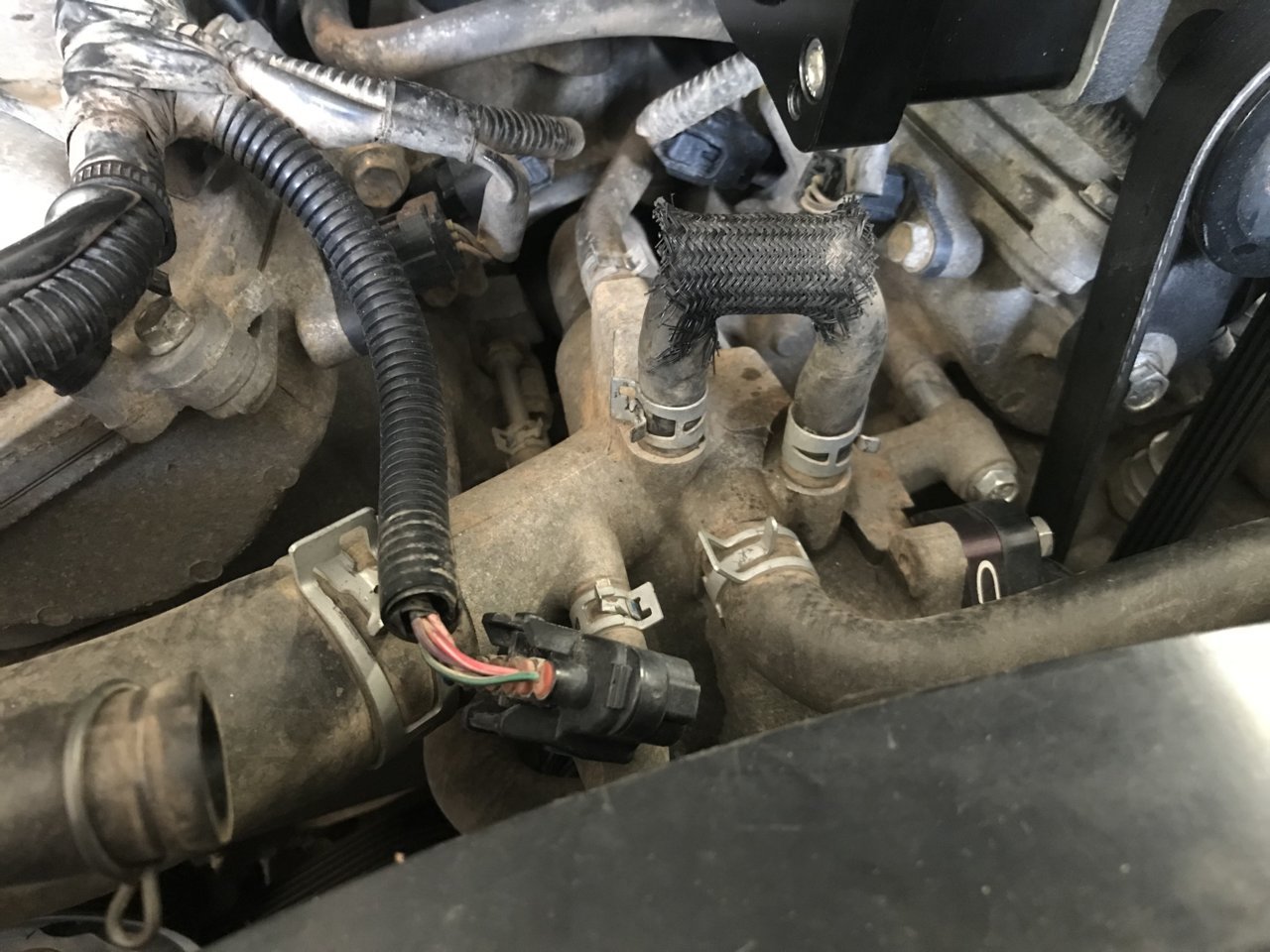

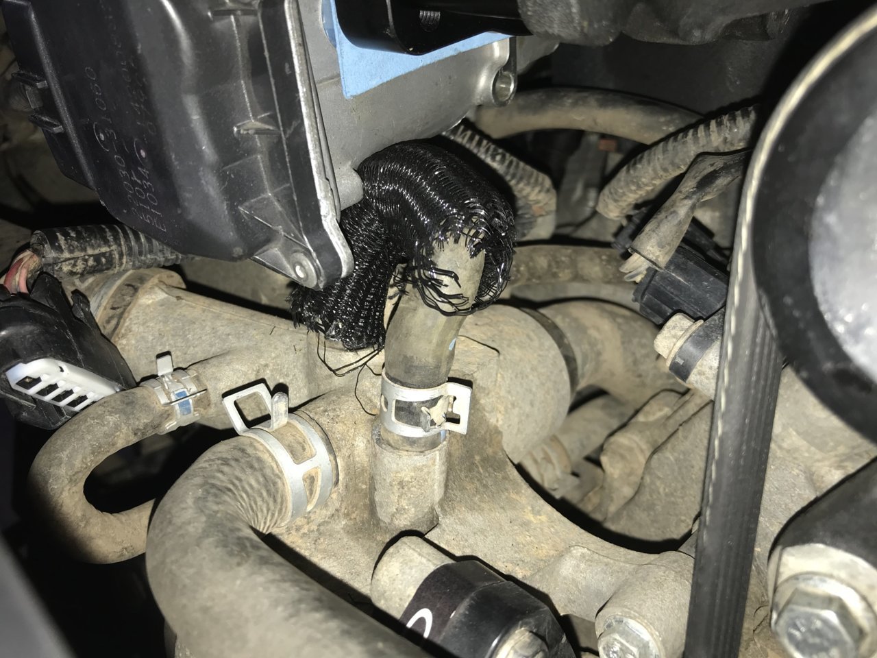

    I put my 70 mm TB On this past weekend. First I’m seeing of problems with them. We shall see I guess. I haven’t had a chance to try it out yet, as I’m impatiently awaiting the arrival of my new spindles.
    I didn’t feel like running out for hose, so I used one of the OEM hoses (the shorter one) to loop it for now.
    The TB rubs the coolant hose, so I put a longer piece of anti abrasion covering on it.

    If you cut the taller nipple down a little, you can get the hose to not make contact with the TB.

    Cool. Thank you. I’ll look into it later, as I’ll most likely put the lines back on the TB.

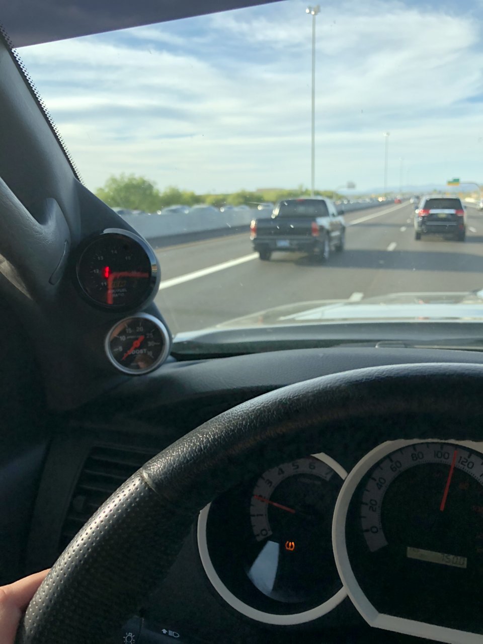

    Boost reference no?

    Thats close to 14.7 considering how sensitive the gauge is.... where is your sensor located?
    I mean, cruising and my aem dances around a few points
