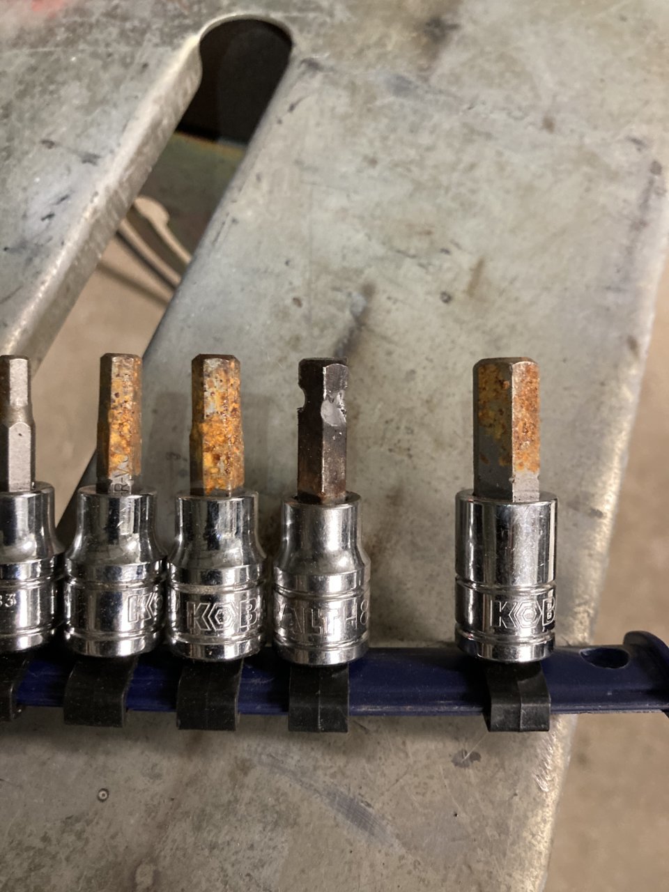

    For this specific reason, I only use the HEX head bung plugs. Stainless. They seize in too easily. The Allen head ones seem to be too soft a steel. Stripped too many.
    A torch on that plug maaaaaayyyy have helped. I have had to drill them out in the past. What a headache.

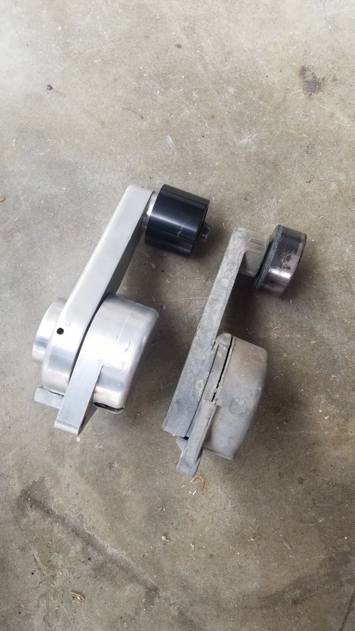

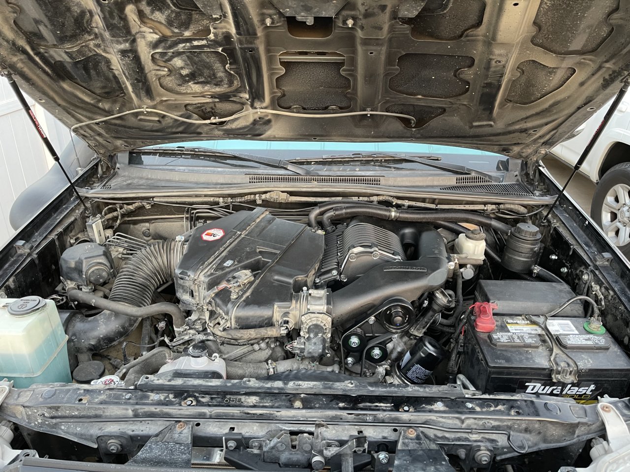

    20210220_114743.jpgFinally got around to installing my Thump tensioner. Been sitting in my box of parts for awhile now.

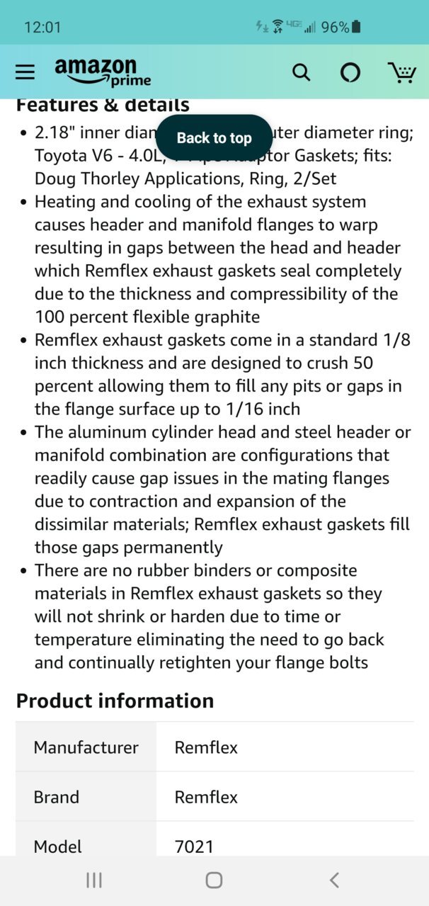

    Two of those are in the manifold to y pipe connections and one of those goes in the y pipe. They should only be a couple of bucks, so I’d get two of each and compare them to the application. You are using these with stock manifolds and y pipe correct?
    The remflex are good gaskets, but do they work for stock manifolds to y pipes?

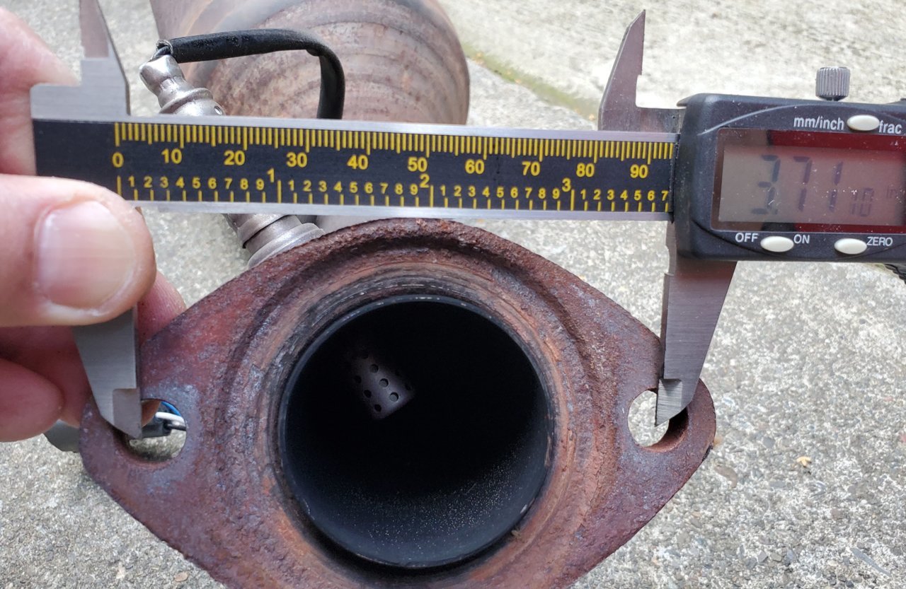

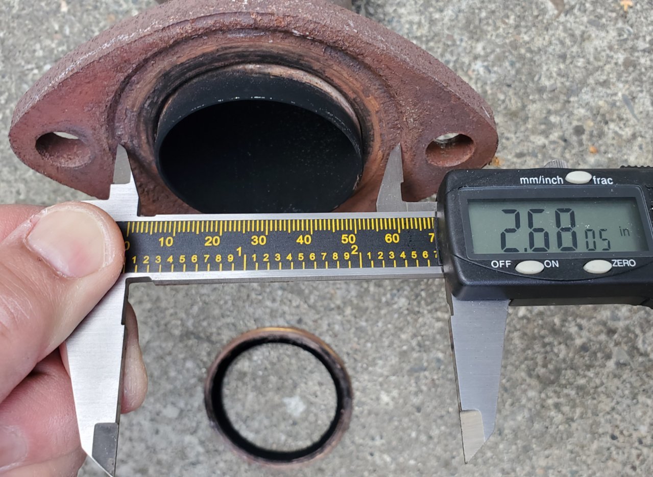

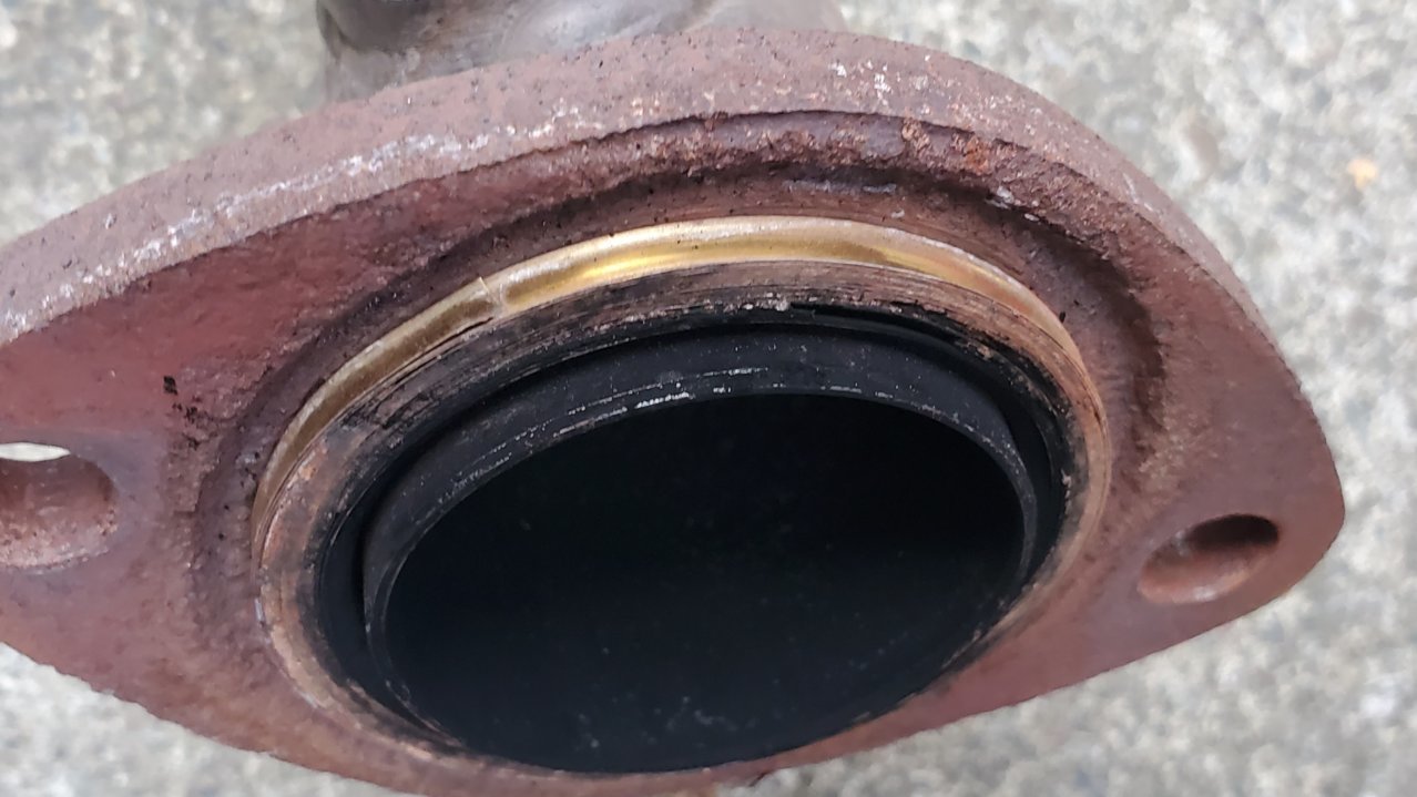

    @Skootter14 i dug my stock y pipe out of the shed. Apparently, im using some sort of crush gasket for the DT shorties+stock y-pipe and I'm using the urd gasket for the DT shorties+URD y-pipe.
    I dont remember exactly but it must have to do with that stepped lip on the factory stuff. I took some photos and measurements.

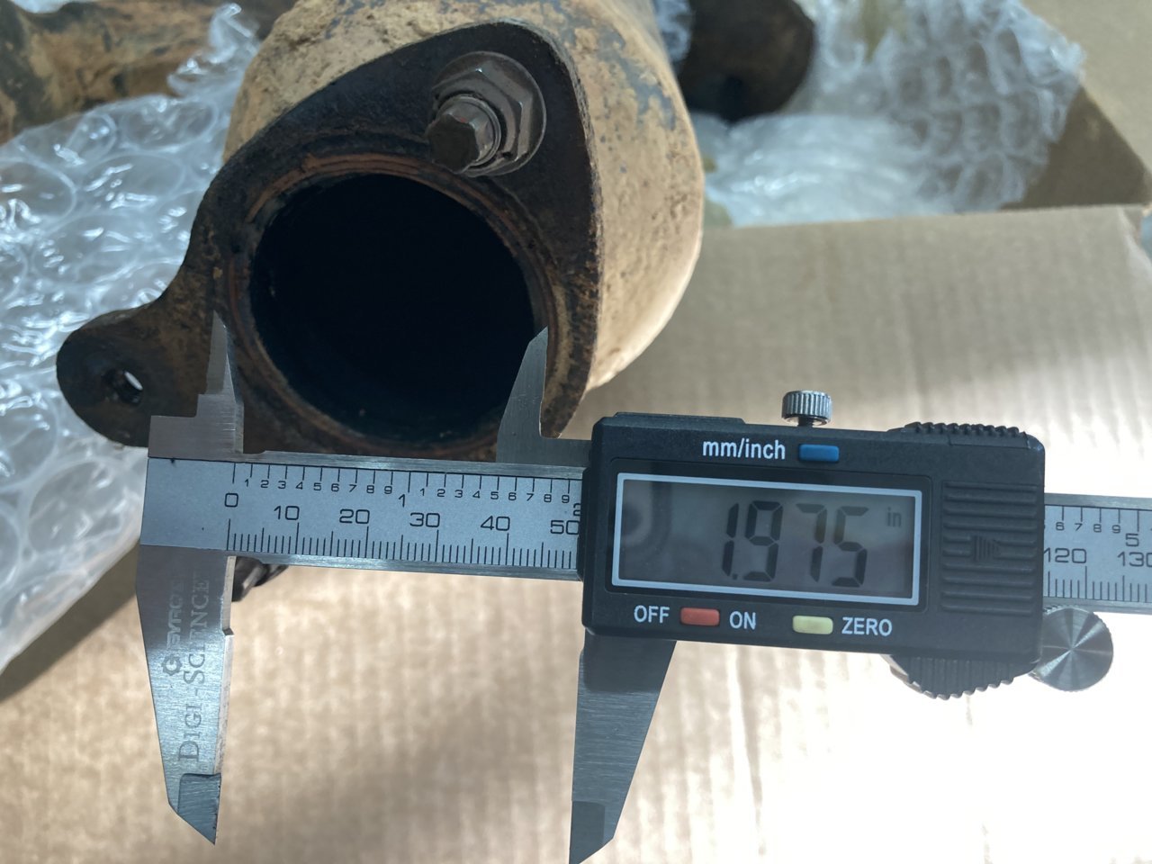

    This should solve it:
    1.98” should fit since OEM ID is that ^

    I have no idea who makes the crush gasket in my photos. Maybe its a factory toyota part? Whatever the case, it is working best for me for the DT shorties and stock y pipe.
    And apparently, I'm using the urd crush gasket when i am using the DT shorties and urd y pipe. I'm assuming that i felt that was the best combo for sealing those two items.

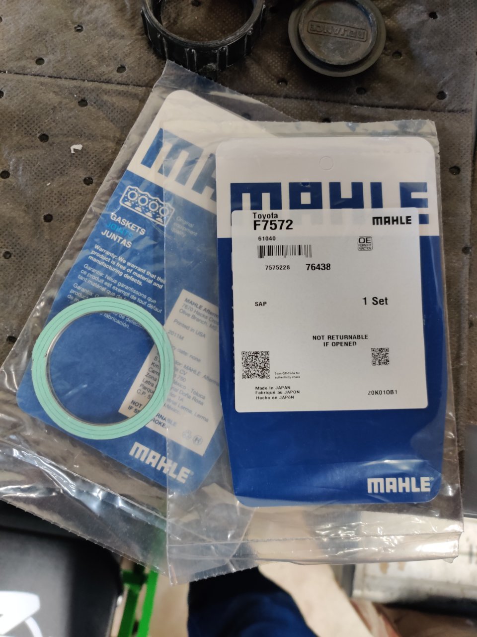

    Advance had these in stock so I’ll pick them up tomorrow. We’ll see if they work or not. If so, we’ll have a part number for future people as well. $5.99

    I'll make it easy. I just bought those gaskets.
    Got them from rock auto cheap.
