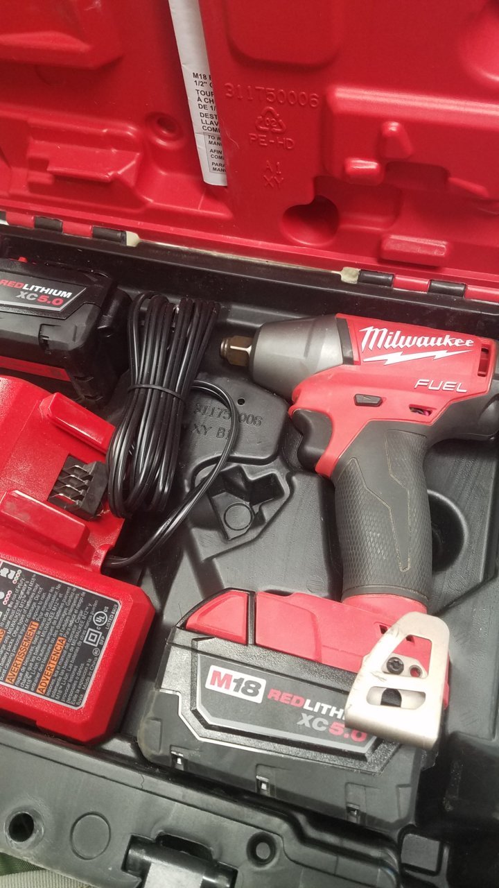

    I used a Milwaukee stubby impact and a few uga ugas and good to go.
