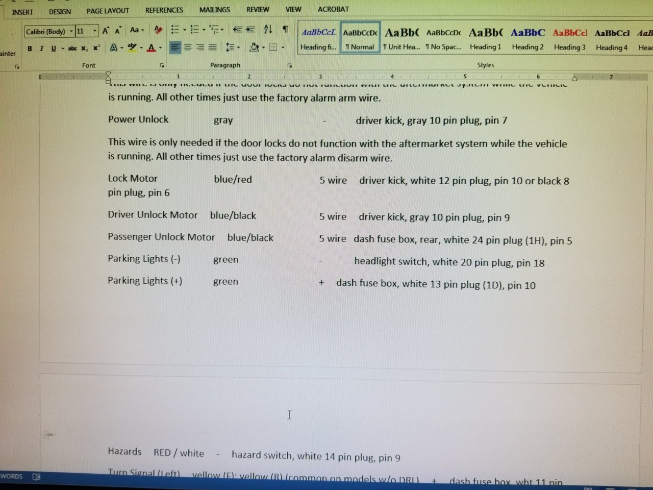

    @Roostfactor, that air pump mounting bracket looks sweet! Any tips on where I can locate an illumination wire for my gauges?

    HPT/justDSM tuned factory ecu, URD Headers, JFR Y-Pipe/l 3" exhaust, Walbro 255 fuel pump, Maggy SC (JFR ported), JFR ported lower intake manifold, 76mm tb, 2.5 pulley, 640cc injectors, CSF Radiator, custom electric fan wit Autocoolguy controller, JFR SC pulley wrap mod
    Green wire. Parking light + on the 13 pin plug. Iirc its behind the fuse box.
