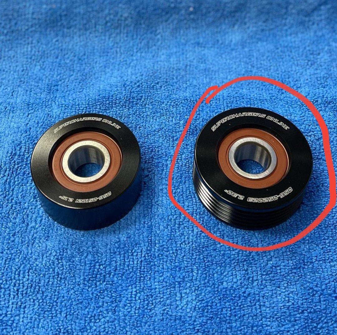

    Disappointing because it's got maybe 1000 miles. Going to douse it with water and see if there's less noise and contact magnuson. But several others have stated there's a cold start squeaking so I didn't give it a 2nd thought, hoping it would go away.

    Any chance it could be one of your stock serpentine belt idler? or are you pretty convinced that it is on the supercharger system?

    Convinced it's the s/c idler. Sound wasn't there before and I've only cleaned out things since I removed the timing cover to do the head gasket. I'll try to rule out the stock idlers as well. Going to mess with it some today before I leave work.
    Edit: it was. I doused the lower and it shut up. Must give a little ptfe spray. I was just trying to avoid using anything but seems like I wasn't the only one living with it.

    Total brain fart. Meant soapy water! Had the kids screaming in the backseat.

    With radiator intact. Stubby impact as previously shown in previous post.
    That one is non removable? It looks like a standard fuse.
    Pick up a new one from Superchargers Online if you can afford to wait. They make a specific ribbed lower pulley and bearing for it.

    No rush at all. I was hoping to ask them to do a group buy for us but seems like they're behind. I'll just spray it for now if I can find my triflow aerosol.

    Yeah it took them all day to contact me back when I was inquiring about the pulleys, then I missed the call when they finally did, and I forgot to call them back.
