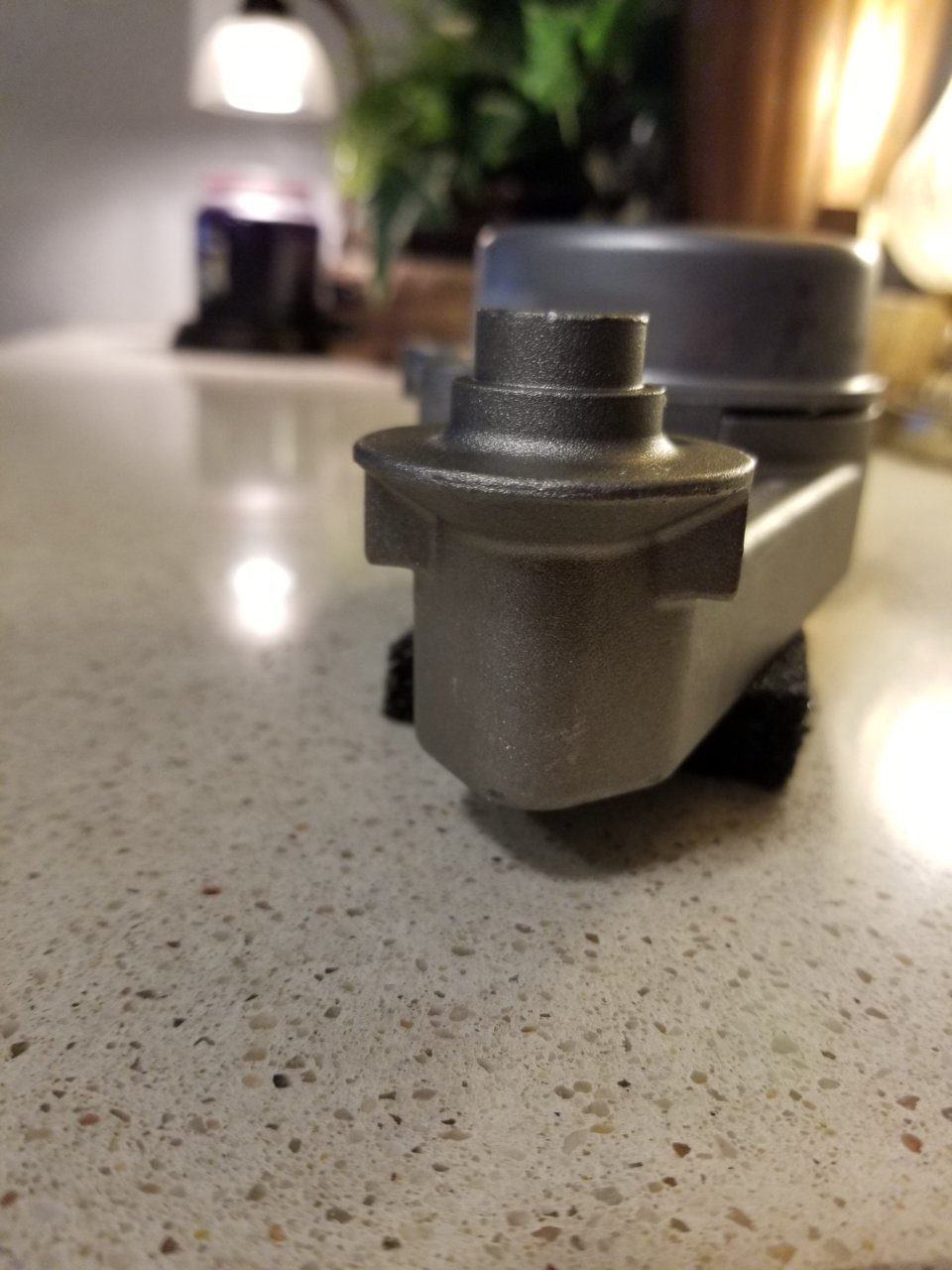

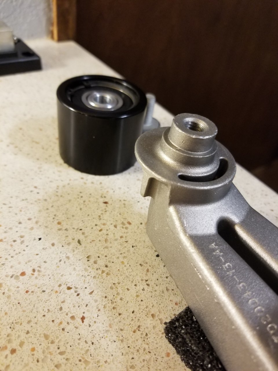

    Does any have a couple of more pictures of the minor, yet critical mod of the roush tension/double bearing modification? Please and thank you. I was gonna put a sharpie to it on all the surfaces that need to be modified.

    Doesn't seem to need too much work done on it.

    Page 1. Snap ring side needs to be facing outward.

    Oh that's right. I thought I added that.
    I picked up literally the last set when I was doing my eFan project. Lol.

    Okay! So only what is shown on Pg. 1 :thumbsup:

    Take more pics post trimming
