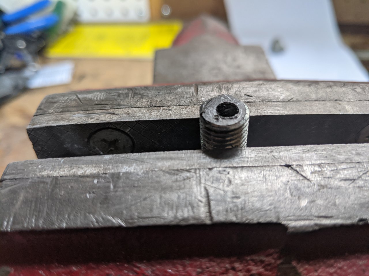

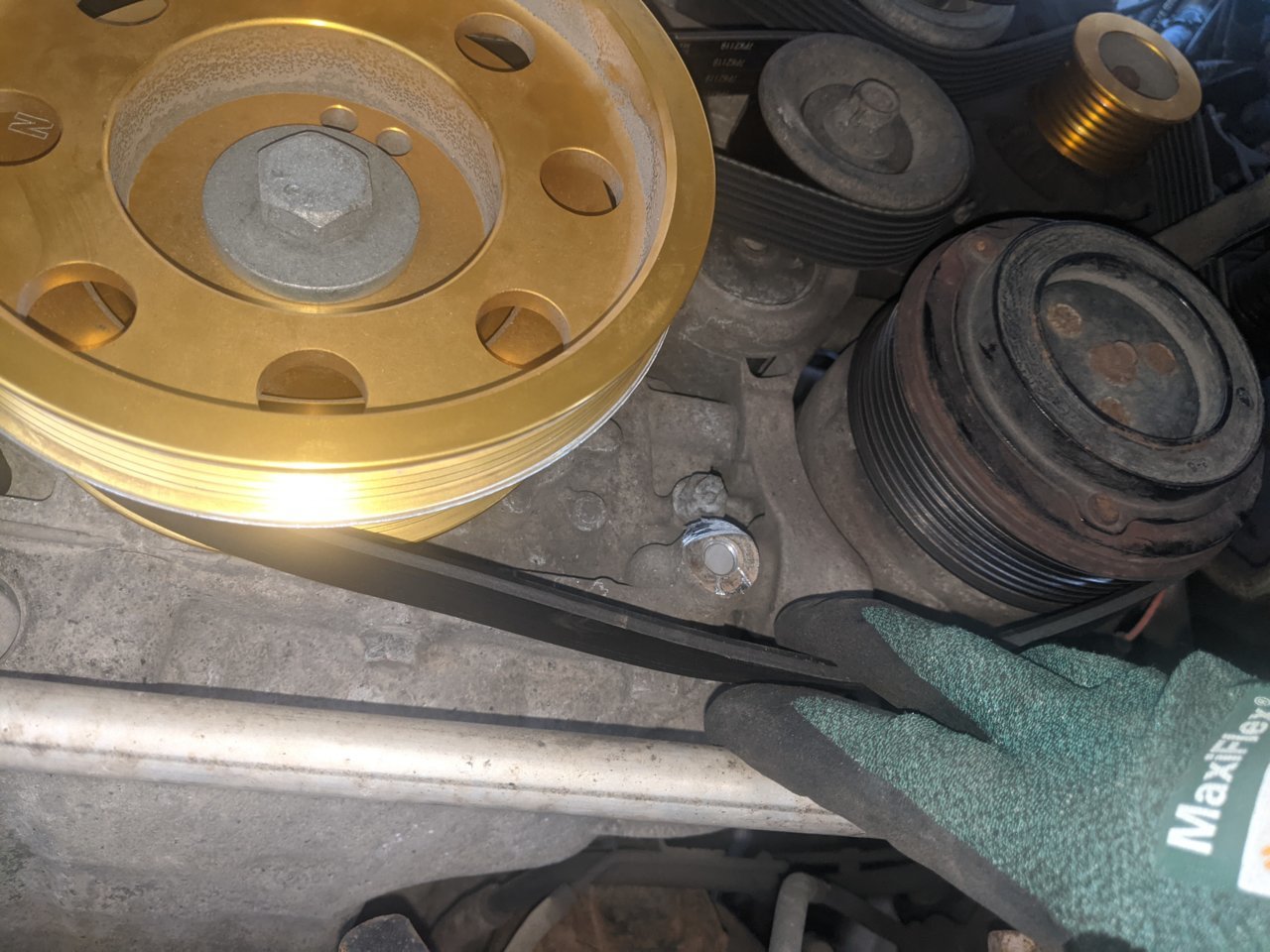

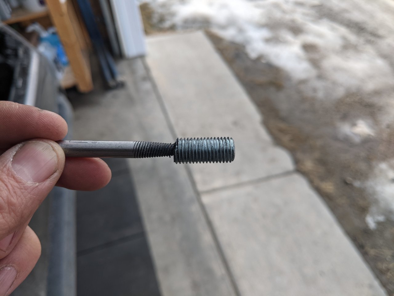

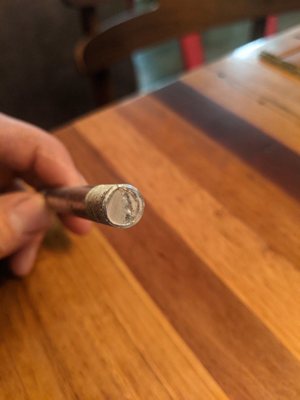

    how do the broken ends look like? a normal shear or fatigue from corrosion/previous cut etc.

    It looks like a really clean break with bare metal. I think either too much tension or a manufacturing flaw or maybe I overtightened the nut and stressed it too much. Hadn't touched the tensioner in around a year.

    I'd say you're unfortunate to have a unique case. Many have the roush and maybe your pulley size w/o a similar failure so most likely manufacturing defect and/or installation failure (idk going off pics) I don't think it's necessary to step up the grade of the stud but could be worth exploring. I wish you good luck in extracting the rest of the stud and reinstallation. Might be worth adding some anti seize on the new stud.

    Gotcha ya wee bastard!
    :quickdraw:
    Real clean looking break.

    As a materials engineer, I am confident in saying this is a material defect - probably something went wrong during the casting process for that part. Not that it will take off the sting of such an annoying thing to have happen, but at least we can say others don't need to worry about this happening to them.
