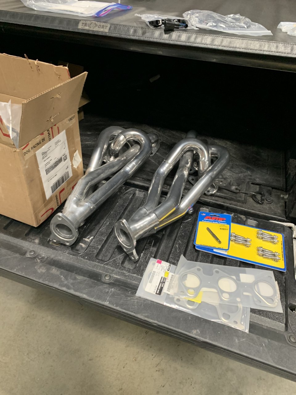

    What do the arp bolts get torqued to for the URD headers??

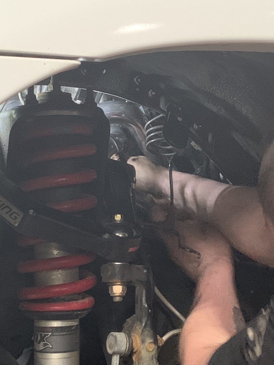

    The coveted driver side went in very easily in a matter of minutes. After undoing the steering shaft and loosening the starter but keeping the top bolt of it lightly threaded gave ample room for the header to slide right in

    Tight. And retighten after a heat cycle. I didn't torque mine.

    Tighten one till it strips, heli coil it, do 10% less on the rest. Seems reasonable no :eek:.
    I didnt torque mine, just snugged them all down as getting at some of them with a torque wrench properly won't be easy

    Fwiw, that was following the factory torque spec of 27 ft lb. Never again
