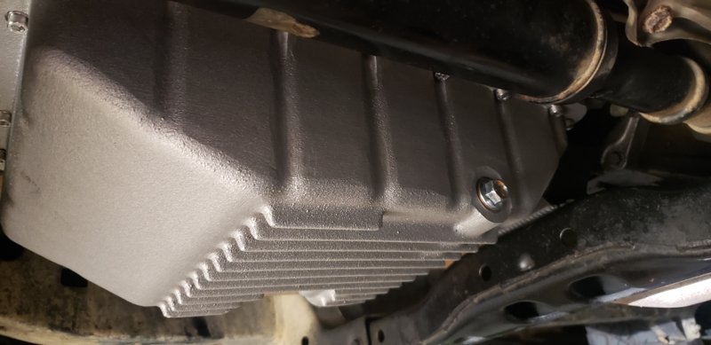

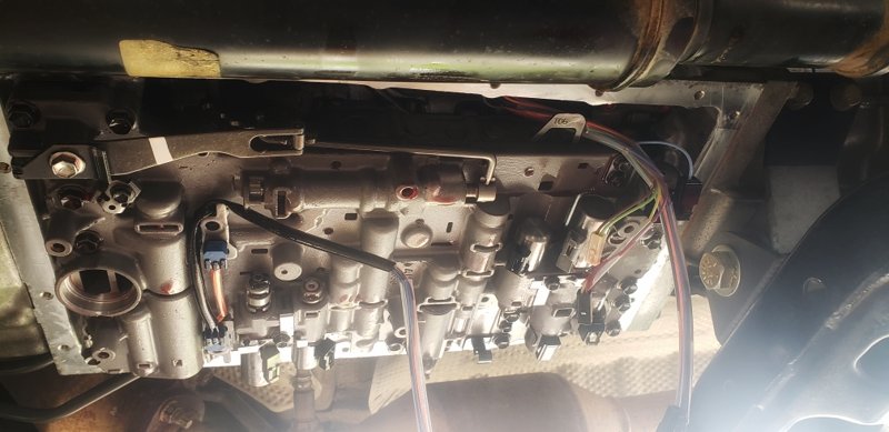

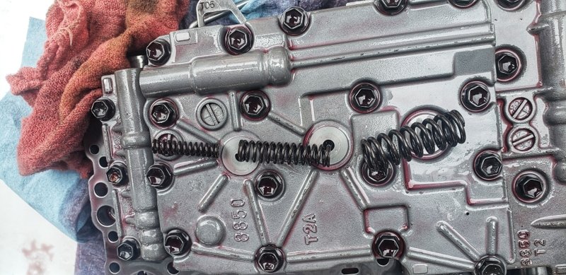

    Seeing your post on back in Jan, reminded me to get on mine. Had it sitting over a year like all good parts collecting

    Shame that pan can't work with the jfr y pipe.

    What pan is that?

    I might do a write up on the transgo kit next

    Thank you @mightytacoman I followed most of your diy walkthrough. Really good help and I was able to document a little on my phone so I could help fill in some gaps like how the the actuators are held in and how you're able to remove. Looking at the pictures helped but also stirred up some anxiety lol. After having everything in hand, made more sense! Which transgo kit? Looking forward to the up date
    @Lucario Runner if John is still making them and up for trying. I'm still in. Asked about some oval piping that'll route under the pan.
    @Biscuits pml covers. +2 quarts extra pan. www.yourcovers.com

    nice! wasn't too bad just need to take your time.
    Def a nice pan, not sure it would clear some other things on my setup as well. @Lucario Runner

    it was def nerve racking just don't blow your rear end right after doing it. that was a panic until I had the rear out thinking I messed up the trans.
    Still some getting used to. that mofo kicks hard in lower gears shifting unless your on the throttle.

    I have a diff drop for my long travel so the skid plates are lowered 1.2" not a bad trade off for me but I hope it's enough to run a jfr pipe in the future
