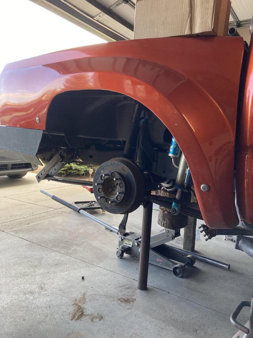

    Just trying to keep peoples trucks from getting wrecked. Also gotta pay for race truck parts.
    Ghetto shackles and upper pivots locked in the geometry for about 19” of travel.
    6D5CA793-BC5E-47A8-9F27-D19D6469C984.jpg C77273B0-DFBF-4E36-AED7-BF955A0E949B.jpg

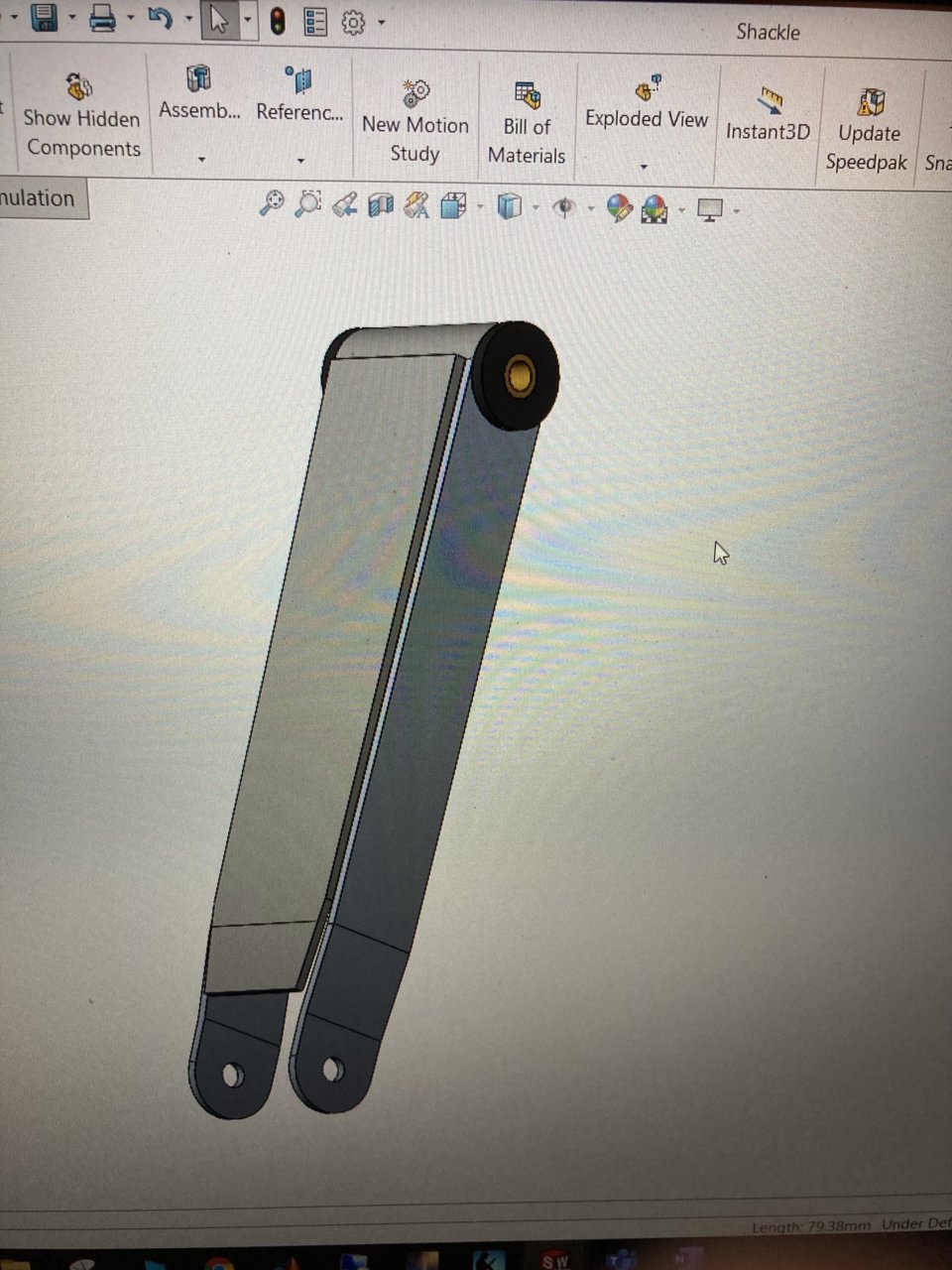

    And designing the fancy stuff to build and keep up on my solidworks.

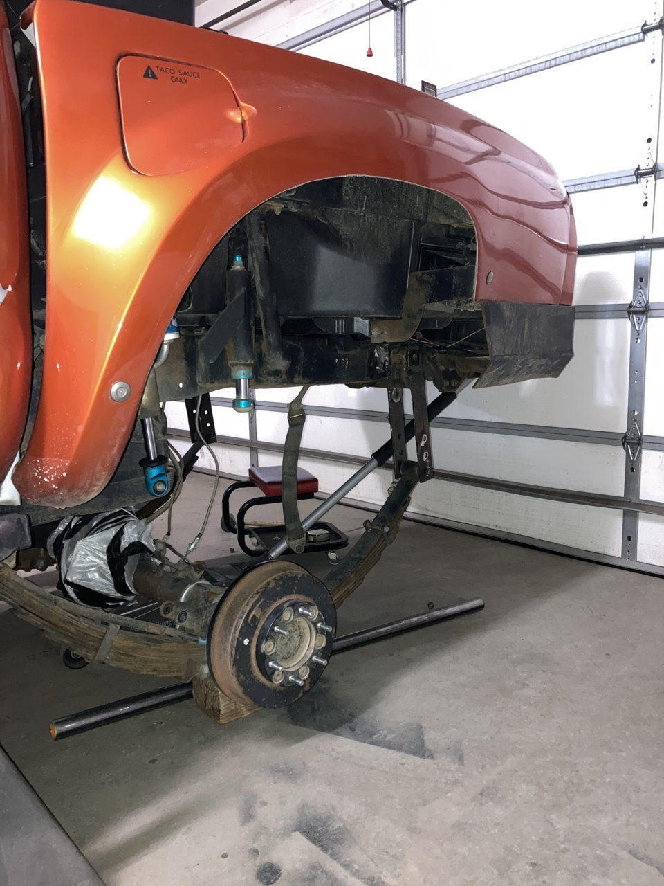

    Nah no links. Just reworking the leaf setup to flip the shackles and ditch the low hanging shackle hanger. Tired of dragging and bending it in the rocks. At least this way the shackle can cycle up and move out of the way.
