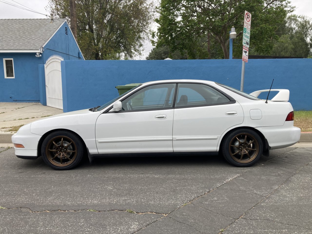

    lol .. ugh, I’ve been working on this. But will most likely replace the truck with a 4Runner, at some point.
    96 GSR 4 door. Just got most of the suspension replaced/upgraded. Rebuilt engine on 60k.

    Your GSR just transported me back to a time when shops/brands like JG, Güde, RevHard, DRAG turbo were prevalent at the local street races......in Mexico.

    That's awesome. I had a red GSR from 2004-2011. Not as clean as that one though.
