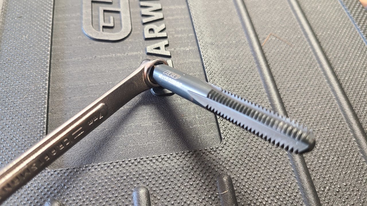

    If I remember correctly, my long tube headers from URD came with studs... something to do with needing longer than stock. Had to swap them out. Might have also just purchased them from URD at the same time, like a, "you will also need..." part.

    Little late to all this but.....I did arp studs. Yes it states they are for LS engines but they are also our size. I also got the chaser to clean out each stud hole. ARP makes a great product. I have them in my Chevelle as well. For my afr gauge, I did the AEM from URD. Can’t remember which one....I believe it’s the only AEM electrical afr gauge they sell.

    I don’t think any company making headers regardless of brand include manifold studs and locking nuts.

    Gotcha should I also get some new ARPs then? What’s the benefit? longer needed I suppose. I’m new to headers

    I got studs with my URD longtubes but I didn’t use them cuz I got the arp’s
