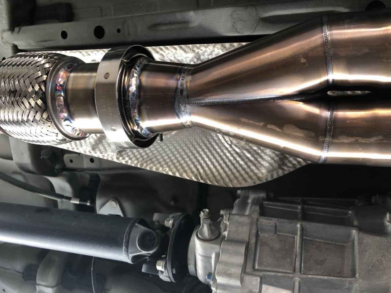

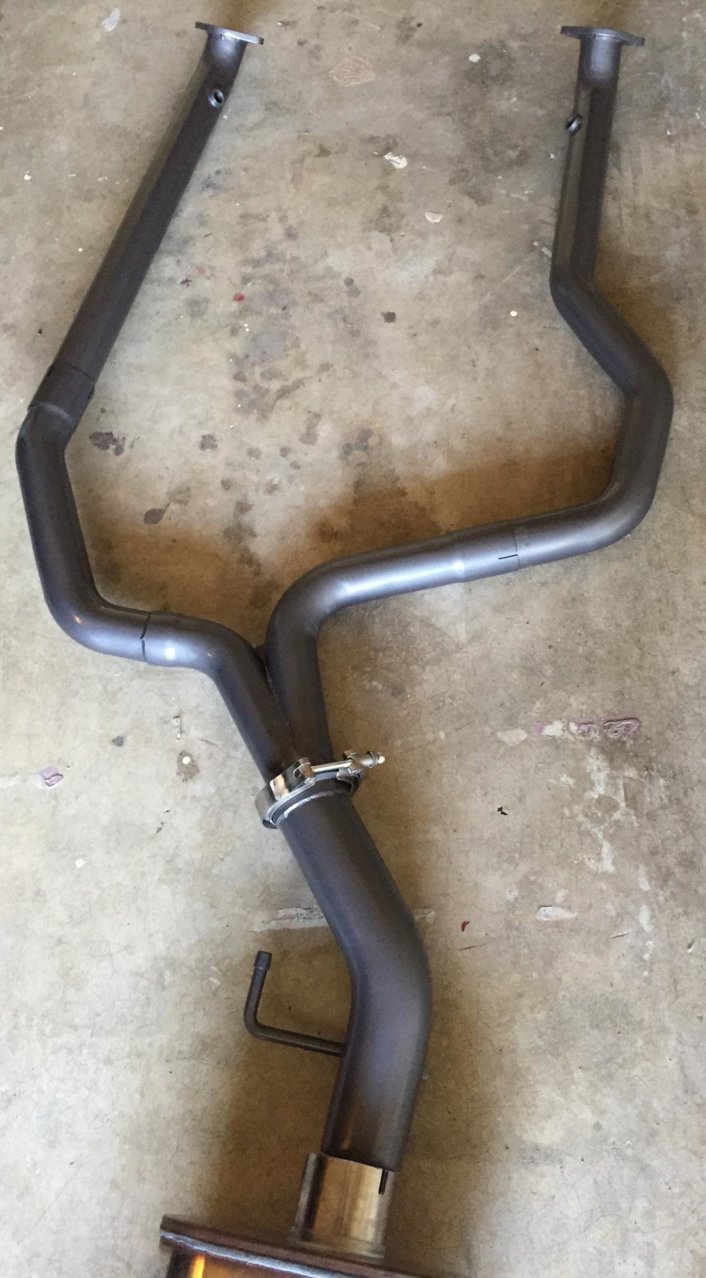

    Wanted to run some ideas by you guys as I'm up in the air regarding what to do.
    The urd spec u exhaust has a nice merge collector with no restrictions (other than 2.25"x2 =7.1 sa and a single 3" is 6.5" sa)
    Roost is a fan of the merge collector going from 2.25" into a 2.5" then coning to 3" to speed up velocity- theoretically increasing scavenging. 2.5" being 4.43" sa
    Now that numbers and visuals are out the way.
    Which do you think would better suit? I'm leaning towards the less restrictive urd version.
    I'll be building my own merge either way. Just seems to me like going from 7.1"sa down to 4.43"sa is fairly extreme.

    The legs are 2.25", yes?
    After burner style. 2.5" - 3"

    Legs are 2.25" on both. After the merge they are both 3"
