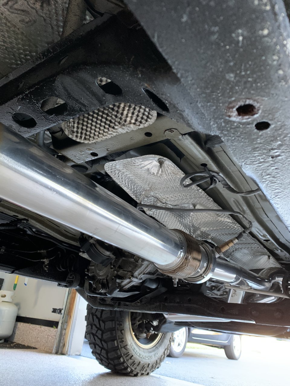

    after the merge what would why you would make part of it flexible?

    The stock donut gasket allows flex. Since you will be removing that, you need to add something to allow some flex for when the engine is flexing from revving up.

    Very important, especially with the 'pillow' like stock rubber engine/trans mounts.

    makes sense. I just want to make sure I ask him to do it in case it doesn’t come up.
    yah that makes sense. Good to have regardless. I’ll eventually add some solid mounts. Bonson finally released trans mount as well. Still torn between that and DMz’get my
