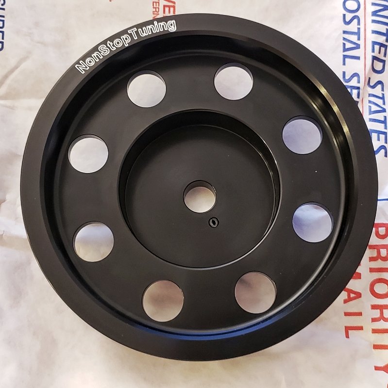

    Received my NST pulley today. Any way you guys recommend torquing without an impact wrench? They don't have the holes for locking it into the damper.
    Also, what do you guys think of the NST alternator pulley? OE pulleys are steel i assume and has some weight to it. Any negative effects so far? I ask because I purposely kept my harmonic damper to avoid weird vibes, etc, even though it probably wouldn't be noticeable at our rpm range

    I'm standard so I had it in gear when I torqued.
    As for the alt pulley, a good impact is the trick by the sounds of it. I used strap wrenches and a ratchet (due to not having a strong impact) and had a hell of a time keeping the alt pulley from spinning. Ended up using knipex pump pliers which wrecked the stock pulley. Then I noticed that the lip was extremely well hidden in the alt body and I had the non-lipped alt pulley so my truck was down for a month until NST exchanged it for the right pulley lol.
    No drawbacks to the alt pulley other than making sure you get the right one. Haven't noticed weird vibrations of any sort with the full pulley set.

    If you are an auto, I would recommend finding a friend with an impact gun.

    I have all the NST pulleys in, as well as a lightweight flywheel. I dont notice any weird vibes or shakes.
    As for torquing, I just put the tranny in 6th... if you're talking about the alternator, I had a pair of welding gloves and just grabbed it with the belt on to keep from moving.

    I believe you ran auto. I just used an impact to put that sucker on. A few ugga uggas and your set.

    You think the Milwaukee 1/2" high torque (1400ft#) is too much?

    Atap on number 1 then 10 ugga uggas on number 2. Mind you this is with a full battery.

    I used the stubby impact 200 or 250 max torque.
    The bug one is 1400 losses. Tighten I think is 400 or so

    It's hard to tell you without looking at the impact gun itself. I usually wind all the guns I have ever used and own to the max setting and then let her rip on the bolt once threaded in correctly. Once it has hit to where it has made contact I tighten until I don't see anymore turning on the bolt or the socket itself, but it depends on the duty of the bolt and what sort of surface it is bolting onto and into. Some threads are more resilient to full cojon contact due to the sheer thread engagement by the bolt. Others will pull quickly once they have been wrenched on if done with too much power or too long. (looking at you supercharger cover lid bolts)
    In this particular case you need a torque of around 180-220 ft. lbs. You need to determine the max torque output indicated ft. lbs. as per the guns specification and then make your determinations from there. Given that the amount of torque you will be needing is above average values you should be safe on the max setting and giving it a several good solid uggas uggas once it has fully seated. If you don't see the socket or the bolt turning any longer then don't keep hammering on it because that's how you pull threads, damage seating surfaces, etc.
    That being said the peak torque of the milwaukee gun has a breaking torque of around 1400 ft lbs on initial full bang if I remember correctly. The nominal continuous torque especially when tightening is a different story. The moral of this long drawn schpeel is to know your tools value wise (no I'm not talking about dollars) and understand their strengths and weaknesses.
