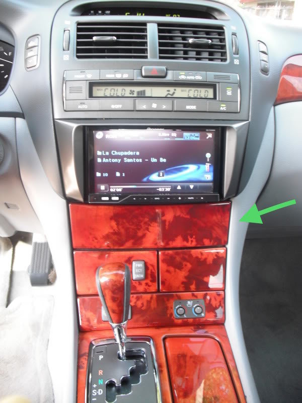

    What 2 gauges can most not live without? Wideband and boost?
    For my Lexus build I’m thinking of hiding 2 gauges behind this cover here. Not very easy to see while driving, as it’s not in my FOV, but everything needs to stay hidden because I don’t want any unwanted attention.

    Wideband is critical, boost arguably less so. Maybe fuel pressure? There are a few gauges, namely from PLX, that have multiple display outputs so in a single gauge, you can have boost, fuel pressure, oil pressure, etc.
