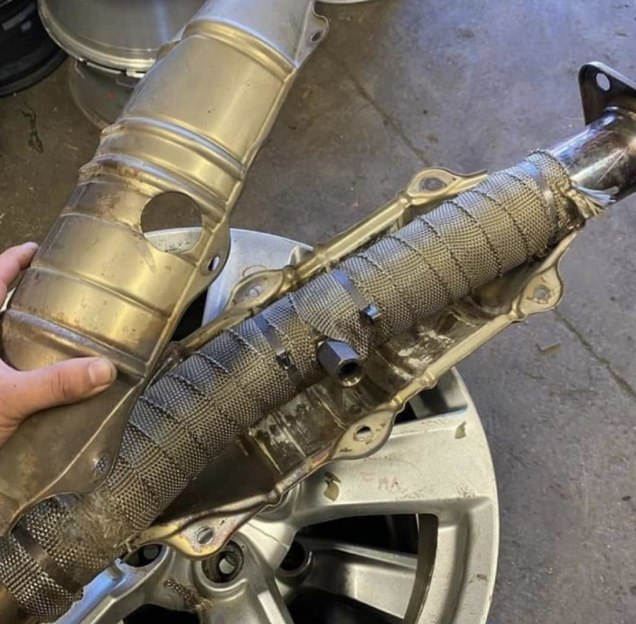

    Ah so that metal tab also helps retain the contact. The tabs on the zzp are smaller than the stock bousch

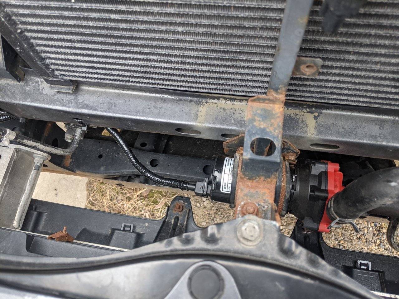

    It makes a nice click when installed and you press on the part that looks like a metal bar to release. Never tried the stock plug but this one fit so perfectly that I never gave it a second thought.
    I wired it up to my relay box and tested it with the old pump then installed the new pump followed by demoing the stock wiring setup.

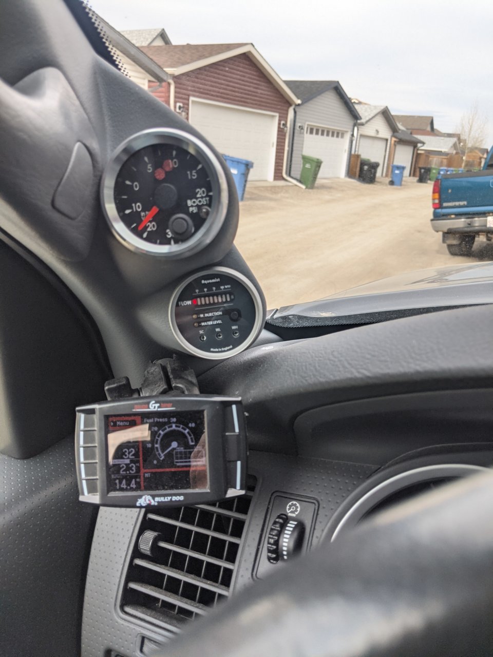

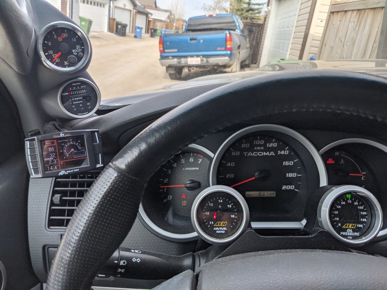

    Finally got a boost gauge and joined the ranks of the lotekians!

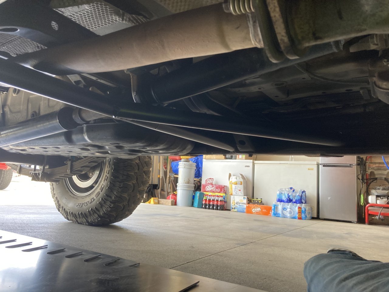

    Cross member in for the anti-wrap bar. Just waiting on the kit to build the bar now. Gotta put the power from the new gears to the ground
    Did have to kink the pipe before the muffler a bit but it was already smashed some from rubicon a few years ago
